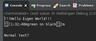

Here's the output to the Eclipse console:
index.php/fa/37014/0/

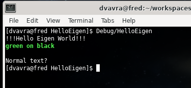

Here' the output to a Linux terminal:
index.php/fa/37015/0/
