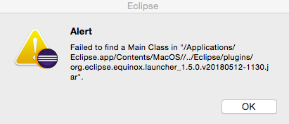

After downloading the application though, I am not given the chance to set anything up at all. index.php/fa/36975/0/(See the attached photo). The program will not run. I understand that I may also have to download a Java 64-bit but I'm not exactly sure what that means.
If someone could tell me what is currently wrong and help me load the program and make sure I can code in Java on it that would be much appreciated! Thank you!

Looks like you're trying to run Photon, the 2018 Eclipse release, on Yosemite, the 2014 macOS release. I'd suggest you try the Installer from https://www.eclipse.org/downloads/ (the download button itself).
The message you're getting is that you must install a valid JDK (Java Development Kit) before trying to run the copy of Eclipse you have downloaded. Go to https://adoptopenjdk.net/ and choose version "OpenJDK 8 (LTS)" and "HotSpot" to download the latest installable that's compatible with Photon. Yosemite is the oldest supported version at the moment--I can't say for sure how long that will be the case.
