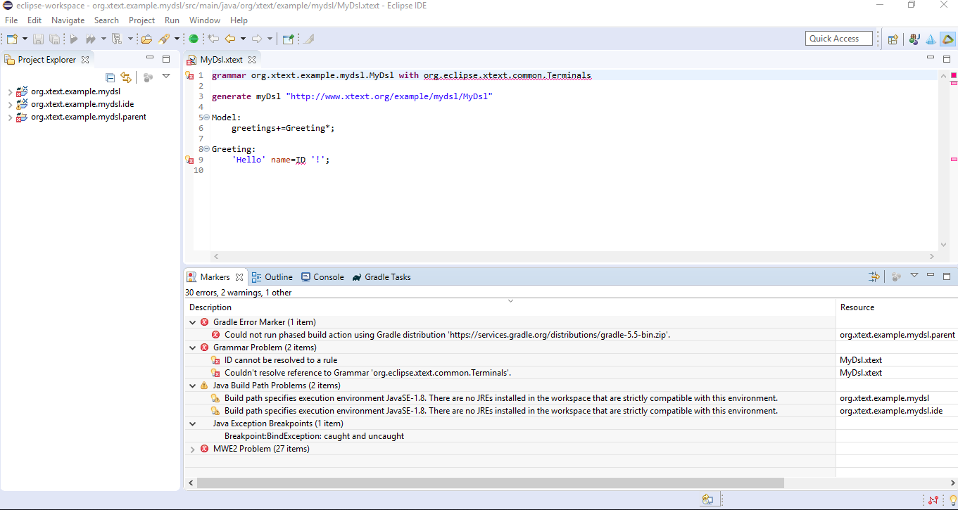

Hi, I want to build a language server for DSL in eclipse. I was following the tutorial on (www.typefox.io/blog/tutorial-building-a-language-server-for-your-dsl). After setting the configuration of the xtext project, errors occur as in the picture attached. I could not solve these errors and Run "Generate xtext artifacts".
  • Attachment: Capture.PNG
    (Size: 70.07KB, Downloaded 104 times)

Re: Build a language server for DSL [message #1818381 is a reply to message #1818374] Fri, 13 December 2019 10:27 Go to previous messageGo to next message
I am using Java 8 and java 11 in the wizard is selected.
The Xtext version is latest, "Eclipse Xtext 2.20.0".
Gradle seems download all dependencies.
But, the error remains.

Re: Build a language server for DSL [message #1818388 is a reply to message #1818381] Fri, 13 December 2019 11:09 Go to previous message
please make sure you use consistent java home versions and selection of java version in new project wizard.
gradle 5.6.x has no support for java 13 nor has xtext. please use java 11 or java 8
