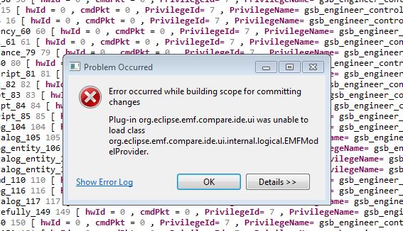

When I run my exported product it is working fine. Runtime eclipse opened successfully and new project also created.
But at the time of commit this project on git we are facing issue. Error popup occurs but after popup closed that project also comitted.
Error is given below:
eclipse.buildId=unknown
java.version=1.8.0_221
BootLoader constants: OS=win32, ARCH=x86_64, WS=win32, NL=en_IN
Framework arguments: -product org.product.configTool
Command-line arguments: -product org.product.configTool -data G:\Kirti\Workspaces\workspace-mpogo/../runtime-configTool.product -dev file:G:/Kirti/Workspaces/workspace-mpogo/.metadata/.plugins/org.eclipse.pde.core/configTool.product/dev.properties -os win32 -ws win32 -arch x86_64 -consoleLog
org.eclipse.egit.core
Error
Thu Dec 12 18:16:38 IST 2019
Plug-in org.eclipse.emf.compare.ide.ui was unable to load class org.eclipse.emf.compare.ide.ui.internal.logical.EMFModelProvider.

  • Attachment: Capture.JPG
    (Size: 77.52KB, Downloaded 146 times)

Re: Plugin not loaded on runtime eclipse [message #1818432 is a reply to message #1818303] Mon, 16 December 2019 02:39 Go to previous messageGo to next message
It looks like you have EMF compare installed and that it's expecting some newer version of Apache logging to be available but only an older one is available. But I don't know what very of anything that you have installed. Likely using an IDE with the latest release 2019-09 (soon to be 2019-12) would have this problem.
Re: Plugin not loaded on runtime eclipse [message #1818435 is a reply to message #1818432] Mon, 16 December 2019 04:13 Go to previous messageGo to next message
I use eclipse version (2019-06). I am using EMF Compare in my code. All plugins available in my product. But at the time of running product my runtime eclipse opened in that eclipse we committed some file that time this error occurs.
Re: Plugin not loaded on runtime eclipse [message #1818438 is a reply to message #1818435] Mon, 16 December 2019 05:12 Go to previous message
Whatever is in your target platform is somehow not consistent. The version of Logger that I see has a setLevel method; at least one that it inherits from org.apache.log4j.Category.setLevel(Level) so you should look closely at what version of that is in your launch.
