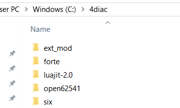

After all, when trying to compile forte, I get the error as shown in the screen shot in the attachments. This is where I don't know how to solve this problem.
I also added the ocnfiguration file and a screenshot of the folder hirarchy I use for compiling forte.
