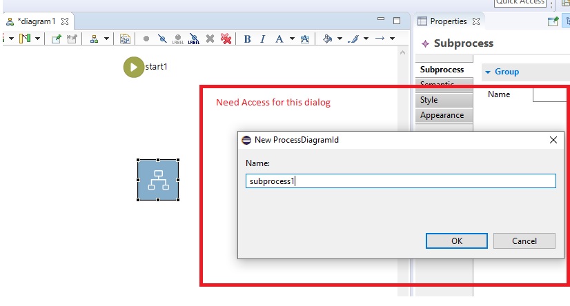

I have created a separate EObject for subprocess and trying to open in separate diagram, so i have used Navigation tool on double click of that Object, it is opening a dialog, can i get Object of that dialog which is created by Sirius framework, i have to apply certain validation like "duplicate subprocess name should not exist", i am attaching snap.

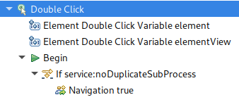

If I understand correctly the structure of your odesign, you used a "Double Click" tool and then a "Navigation" operation inside of it. If that is the case, you can simply wrap the "Navigation" operation inside an "If" operation, and in the condition expression call a Java service to perform the validation (and return true/false). See https://www.eclipse.org/sirius/doc/specifier/general/Writing_Queries.html#service_methods for how to write Java services. The condition expression of the "If" operation will be executed in the context of the element you double-clicked on, so in your service method it will be provided as the first argument (typically called "self", but that is only a convention). See attached screenshot if I am not clear.
