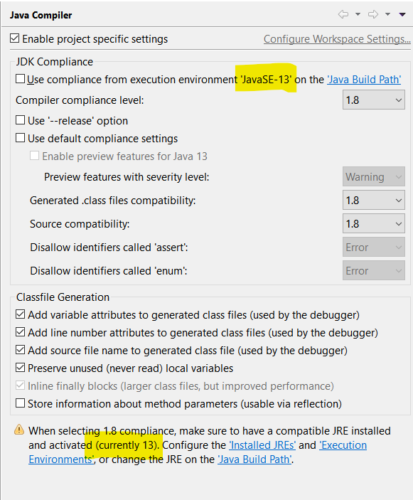

Using Version: 2019-09 R (4.13.0) on windows 10
Java openjdk-13.0.1_windows-x64_bin.zip
Settings:
index.php/fa/36953/0/
Works just fine.
