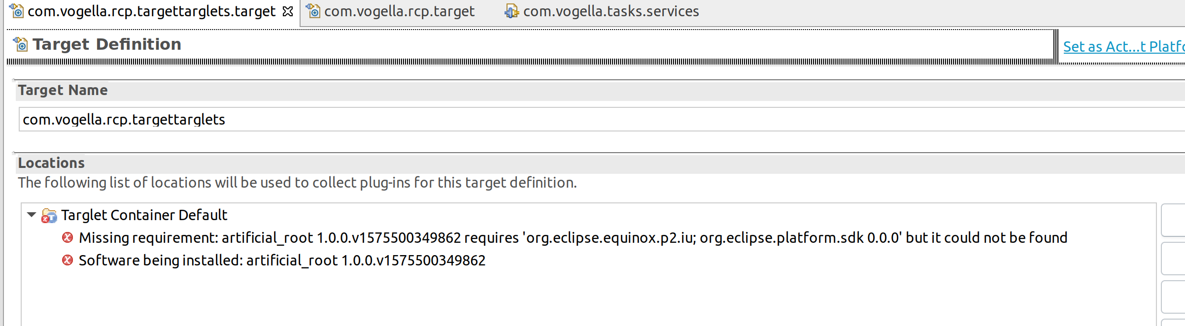

I'm trying to convert a target definition file to a targlet. For the setup I followed https://wiki.eclipse.org/Oomph_Targlets
AFAICS the repository browser does not allow to search for ID, see https://bugs.eclipse.org/bugs/show_bug.cgi?id=553786 so I might have done something wrong.
Here is my target definition file:
<?xml version="1.0" encoding="UTF-8" standalone="no"?>
<?pde version="3.8"?>
<target name="com.vogella.rcp">
<locations>
<location includeAllPlatforms="false" includeConfigurePhase="true" includeMode="planner" includeSource="true" type="InstallableUnit">
<unit id="org.eclipse.equinox.sdk.feature.group" version="0.0.0"/>
<unit id="org.eclipse.platform.sdk" version="0.0.0"/>
<repository location="http://download.eclipse.org/releases/latest"/>
</location>
<repository location="http://download.eclipse.org/tools/orbit/downloads/drops/R20190226160451/repository"/>
<unit id="com.google.gson" version="0.0.0"/>
</location>
</locations>
</target>
And I think this should be the targlet file containing the same:
<target name="com.vogella.rcp.targettarglets">
<locations>
<location xmlns:targlets="http://www.eclipse.org/oomph/targlets/1.0" xmlns:xsi="http://www.w3.org/2001/XMLSchema-instance" id="Default" type="Targlet">
<targlet includeAllPlatforms="true" name="Eclipse RCP" xsi:type="targlets:Targlet">
<requirement name="org.eclipse.platform.sdk"/>
<requirement name="org.eclipse.equinox.sdk.feature.group"/>
<repositoryList name="http://download.eclipse.org/releases/latest"/>
</targlet>
<targlet includeAllPlatforms="true" name="Orbit" xsi:type="targlets:Targlet">
<repositoryList name="http://download.eclipse.org/tools/orbit/downloads/drops/R20190226160451/repository"/>
</targlet>
</location>
</locations>
</target>
But I get an error, see screenshot.
Can you advice, what is wrong?
Best regards, Lars

Re: Converting a target definition file to targlets results in an artificial_root node error [message #1818064 is a reply to message #1818061] Wed, 04 December 2019 22:20 Go to previous messageGo to next message
I returned https://bugs.eclipse.org/bugs/show_bug.cgi?id=553786 as works for me.
In terms of your error, a Repository List is not a Repository. So you have a Repository List whose name is p2 URL and it has no Repositories in that list. Be sure to look at the details of the Task on the Confirmation page to see that it has expanded to the expected.
Here's how the "Eclipse Platform" Modular target looks in the Eclipse Projects
<setup.targlets:TargletTask
    xmi:version="2.0"
    xmlns:setup.targlets="http://www.eclipse.org/oomph/setup/targlets/1.0"
    xsi:schemaLocation="http://www.eclipse.org/oomph/setup/targlets/1.0 http://git.eclipse.org/c/oomph/org.eclipse.oomph.git/plain/setups/models/SetupTarglets.ecore">
  <targlet name="Eclipse Platform"
      activeRepositoryList="${eclipse.target.platform}">
    <repositoryList
        name="None"/>
    <repositoryList
        name="2019-12">
      <repository
          url="http://download.eclipse.org/eclipse/updates/4.14-I-builds"/>
    </repositoryList>
    <repositoryList
        name="2019-09">
      <repository
          url="http://download.eclipse.org/eclipse/updates/4.13/R-4.13-201909161045"/>
    </repositoryList>
<!-- and more.. -->
    <repositoryList
        name="Galileo">
      <repository
          url="http://download.eclipse.org/eclipse/updates/3.5/R-3.5.2-201002111343"/>
    </repositoryList>
  </targlet>
</setup.targlets:TargletTask>
Note that the activeRepositoryList attribute determines which RepositoryList is active, so you can specify many different target platforms via a single Targlet task.
Also note that you can drag a *.target (from the Explorer) and drop it on a Targlet task (and only on such a task), to convert it to a Targlet of that task in order to simplify/automate this conversion process.
