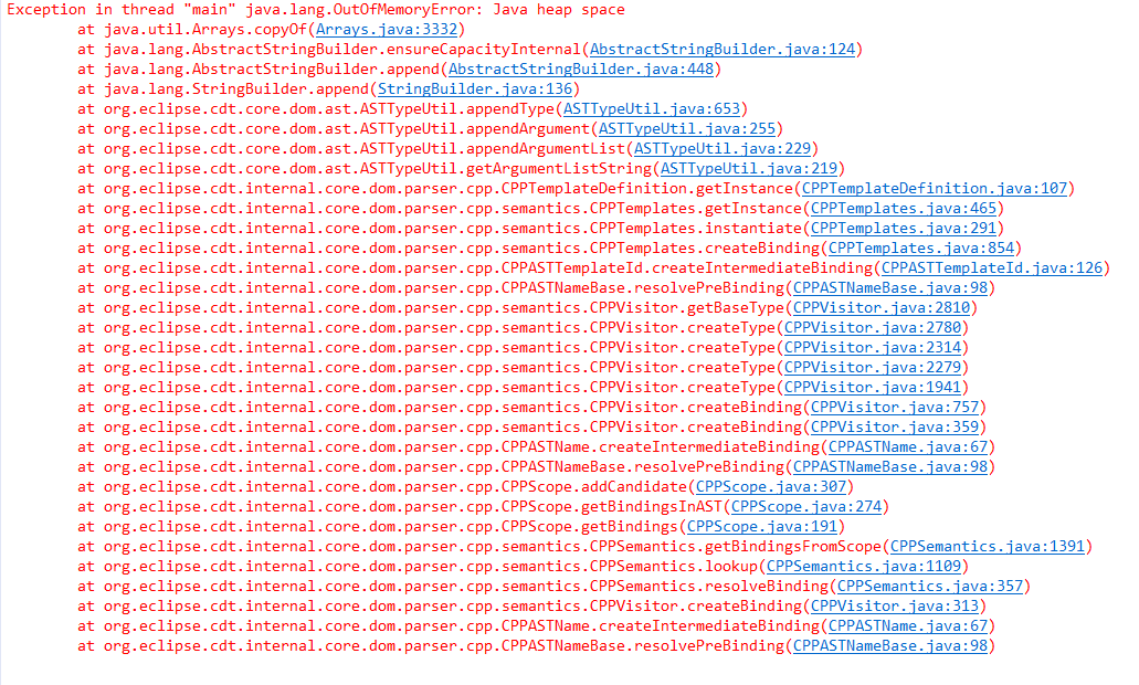

FileContent fileContent = FileContent.createForExternalFileLocation(fileLocation);
            IScannerInfo scannerInfo = new ScannerInfo();
            IncludeFileContentProvider readerFactory = IncludeFileContentProvider.getEmptyFilesProvider();
            IASTTranslationUnit tu = GPPLanguage.getDefault().getASTTranslationUnit(fileContent, scannerInfo,
                readerFactory, null, ILanguage.OPTION_PARSE_INACTIVE_CODE, new DefaultLogService());
            System.out.println(tu.getRawSignature());
There is a java.lang.OutOfMemoryError when I use the code to parse a single file. Is it a bug or not?

Don't know if it's a bug or not.
The file is rather complicated.
Try inserting the code in pieces until you encounter the problem.
I tried doing so and got to line 195 but it failed after that.
After the problem occurred, I had to delete the .cproject, .project files and .settings dir.
It was a nuisance recreating them.
Start a new project without the main.cpp file.
save the project files.
Add pieces from main.cpp until the error occurs.
There may be something obvious that you can fix.
You can also increase JVM heap and see if that helps.
https://wiki.eclipse.org/FAQ_How_do_I_increase_the_heap_size_available_to_Eclipse%3F

Thanks for your reply. I have already report it to CDT team. You can check BugId 553613 to see.
