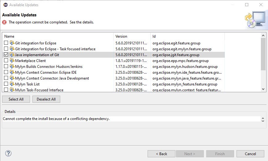

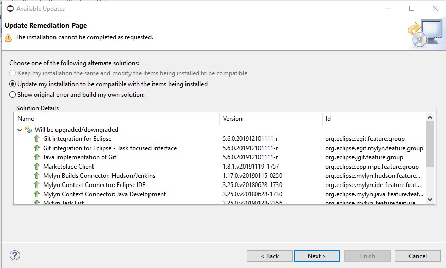

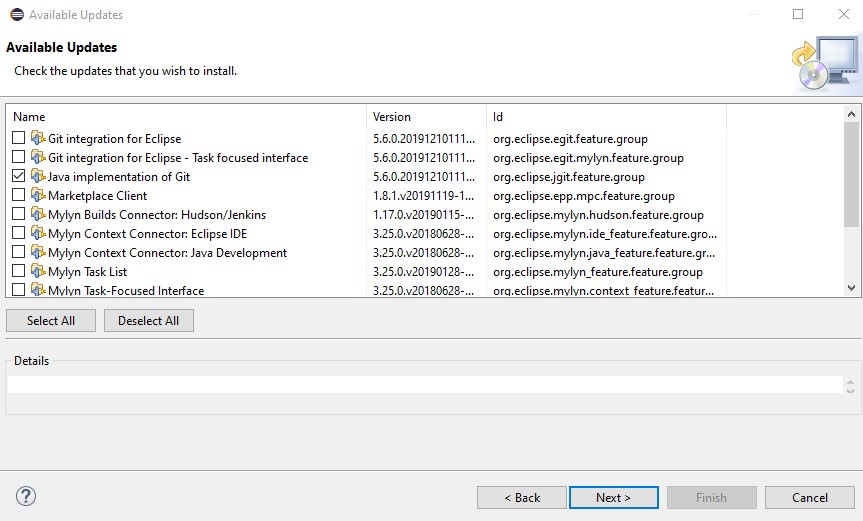

Re: Can't update EGit [message #1820868 is a reply to message #1817491] Thu, 30 January 2020 15:43 Go to previous messageGo to next message
I have a similar problem with updating egit in Eclipse 2019-09.
I have tried some of the (many!) suggestions at StackOverflow question 6470802/what-to-do-about-eclipses-no-repository-found-containing-error-messages. (Sorry, as a newbie to eclipse.org, I'm not allowed to include external links in my posts so you'll have to construct your own URL if you want to read those suggestions & discussion.)
I have tried all three options on https://www.eclipse.org/egit/download/.
I plan to nuke my current installation of Eclipse and try my luck with a different version.
But... just in case it helps someone to localise & repair the defect, I have attached some screenshots, my Help/About Eclipse IDE/Installation Details/Configuration, and my error log.
Re: Can't update EGit [message #1821034 is a reply to message #1820868] Tue, 04 February 2020 11:58 Go to previous message
if you increase the window size of the installation dialog there should be more details shown about which conflicts are preventing the upgrade
