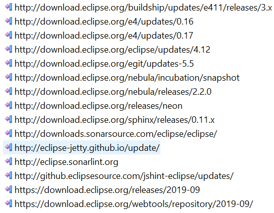

Recently i upgraded all my target platform plugins to latest like the above attached file.
When i am trying to build the plugins with tycho version 1.4.0 with JDK 11, i am facing the below error ,
can you please let me know the problem.
