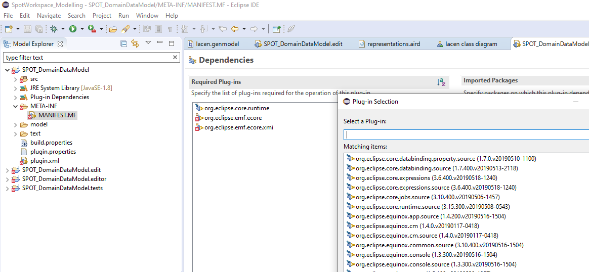

Result:!!!!!!! The projects (Model, Model edit end Model Editor are no more ok why?
Because in the model the plugins org.eclipse.emf.ecore and org.eclipse.emf.ecore.xmi which are in the dependencies are no more here and worst they are no more accessible in the list!!! The proof cf image Bug1:
index.php/fa/36794/0/
Question how we can do to use EMF model with RAP??????

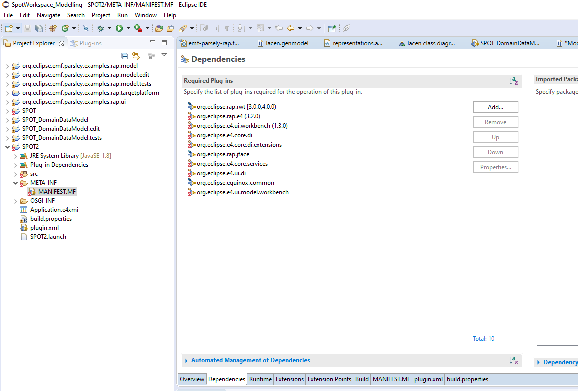

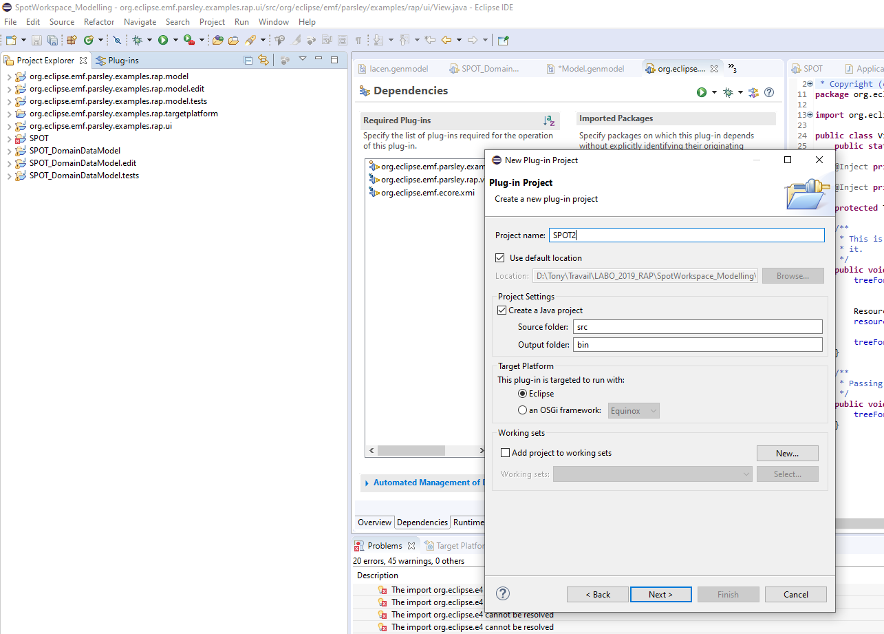

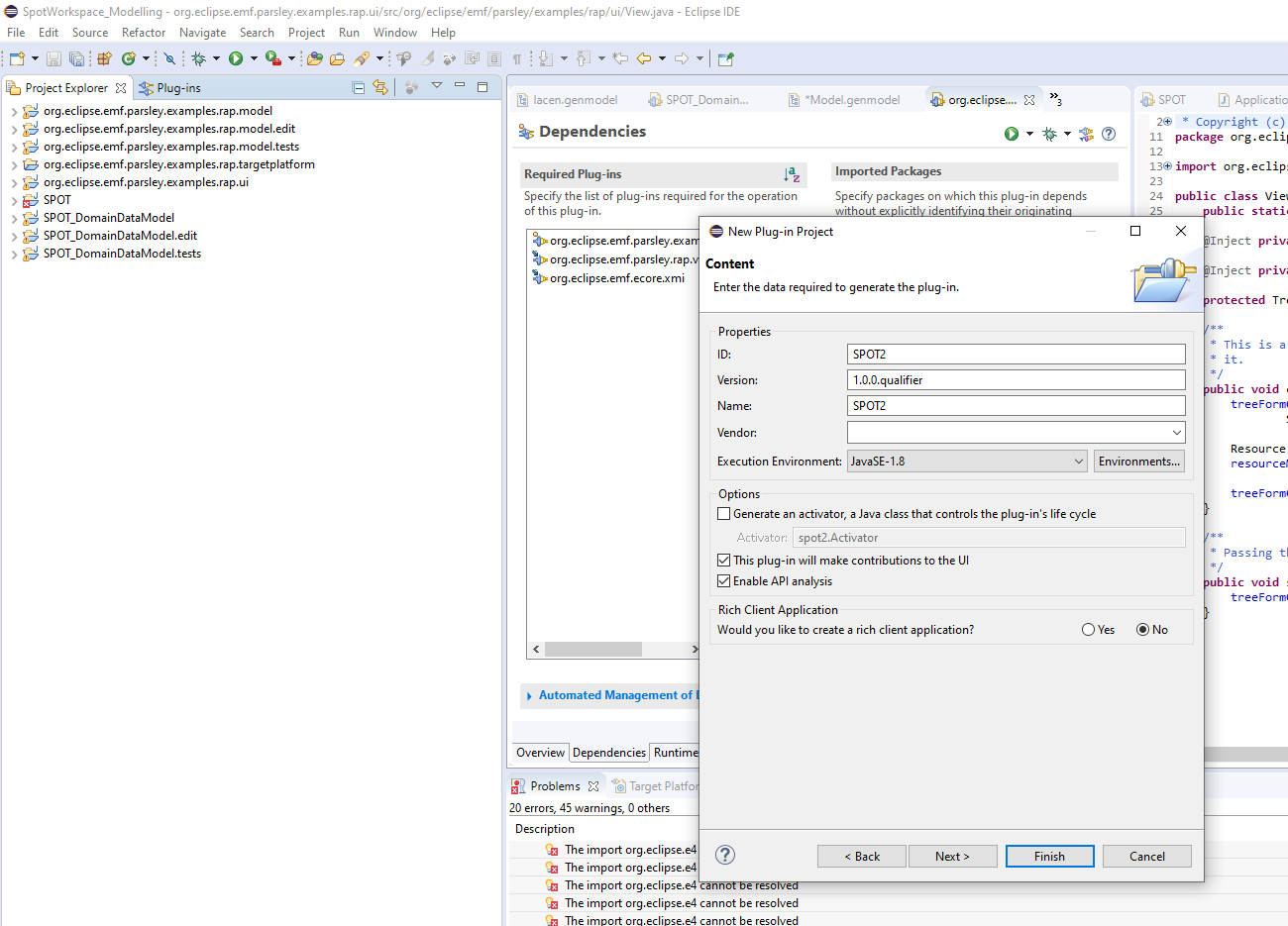

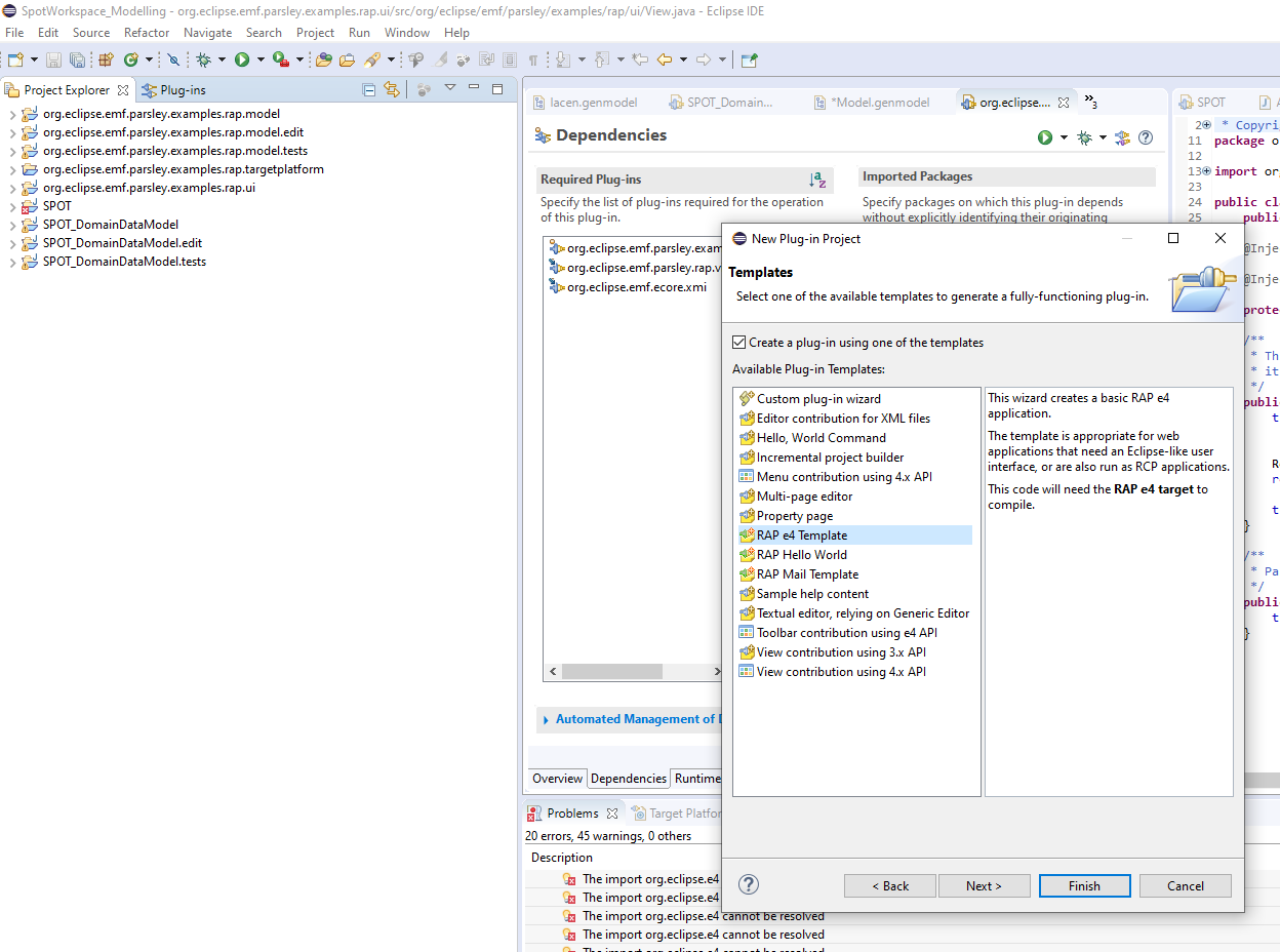

I create a project using "Plugin-Devleoppement" and I want a RAP e4 template. In this case I have still a lot of plugins not available:
Step1: Create the project plugin:
index.php/fa/36797/0/

index.php/fa/36798/0/
Step3:Define the plug-in we want use:
index.php/fa/36799/0/
Step4 the result with a lot of plugin missing ??????
index.php/fa/36800/0/
Have you an idea to be able to build this kind of project?
Best regards
Antonio

Re: Eclipse modelling IDE and RAP [message #1817379 is a reply to message #1817375] Thu, 21 November 2019 07:45 Go to previous messageGo to next message
Hi Antonio,
I'm pretty sure the problem is that our Target Definition file emf-parsely-rap.target (the first step of the tutorial) does non include the RAP e4 plugins and/or features.
But I wouldn't know which should be added.

Re: Eclipse modelling IDE and RAP [message #1817411 is a reply to message #1817392] Thu, 21 November 2019 13:09 Go to previous messageGo to next message
Hi Vincenzo,
I Think are missing:
org.eclipse.rap.e4
org.eclipse.e4.ui.di
org.eclipse.e4.ui.services
org.eclipse.e4.ui.workbench
org.eclipse.e4.core.contexts
Best regards
Antonio
