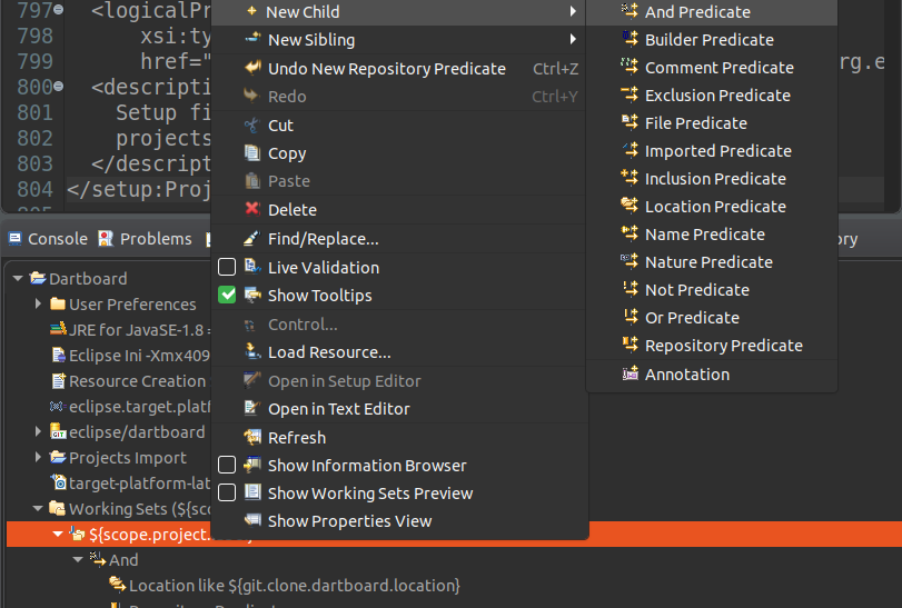

> Why not just use the same repository predicate?
I only see the Repository predicate (see screenshot). AFAICS this predicate requires that I configure another project from the repo as reference If I want to add several Git repos to my workspace setup that is a lot of maintenance. and as the project may change over time, time consuming to maintain.
As Project Import can use the Git repos as reference, I hope that Working Sets can use the same.
Or maybe I misunderstood you and I oversee a easy solution.
