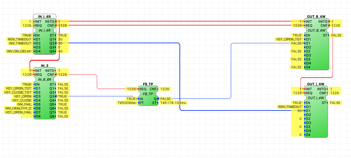

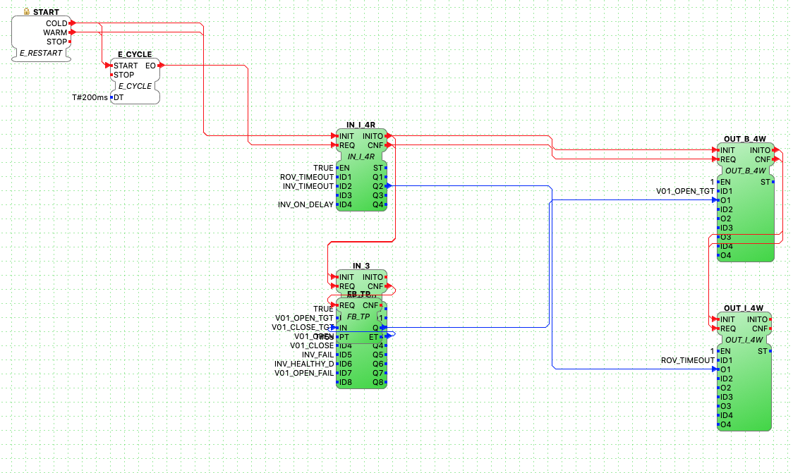

We have been working on creating some function block to interact with a remote OPC_UA server. The example below shows inputs on the left and output on the right hand side. It is implemented by using an E_CYCLE event to drive clock timer (this is on the EMB_RES page), which clocks the OPC_UA READs for the inputs and WRITEs for the outputs.
As an example, IN_I4R, is a 4 input Integer (16 bit), The ID1 gets mapped to a OPC_UA string used for in the CLIENT_0_1 with a ID like this: opc_ua[READ;opc.tcp://opcserver:4840#;,1:s=VAR.ROV_TIMEOUT]. The output function blocks uses the CLIENT_1_0 with an ID opc_ua[WRITE;opc.tcp://opcserver:4840#;,1:s=VAR.V01_OPEN_TGT].

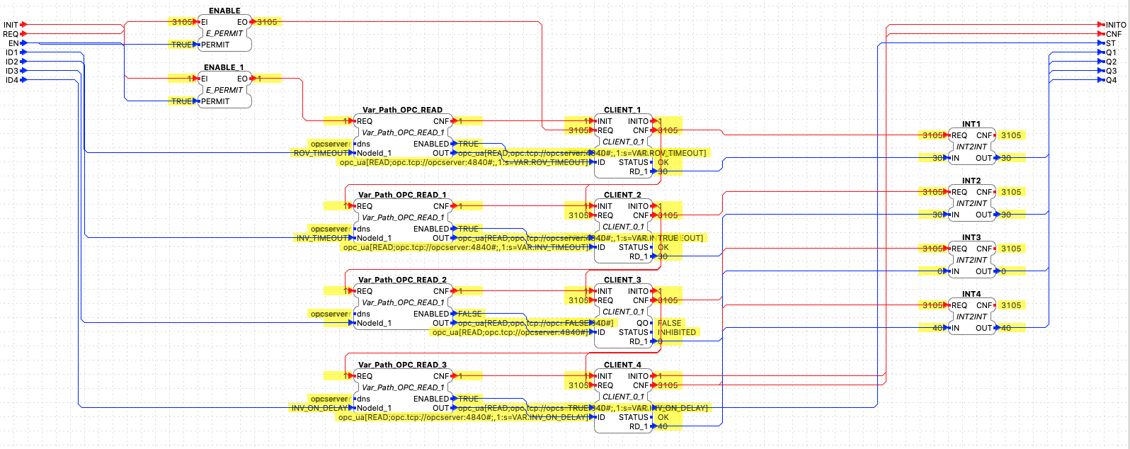

The detail behind the IN_I_R4 function block is as below:
index.php/fa/36739/0/

Re: OPC READ question [message #1816985 is a reply to message #1816980] Wed, 13 November 2019 07:08 Go to previous message
The external queue full means that you are creating external events (in this case from E_CYCLE) faster than forte can process them, so you need to reduce this processing time
Some thoughts about this:
1- VAR_PATH_OPC_READ_2 has an empty input and is not actually reading anything. Remove it if not used, or skip the CNF triggering
2- Maybe, and I'm not sure about this, but maybe it's better to not have 2 events coming out of CNF, but just to the next CLIENT and then to the int2int and follow the change with the rest of the int2int similarly
3- You could use a CLIENT_0_4 to pack all READ in one, making only call to the OPC UA stack instead of 4 of them. I think that'll help a lot.
But to have a deterministitc behaviour you should start looking into real time systems I think. I know there are some FBs for it, but @Alois could give more information about it, since he used them a while ago.
