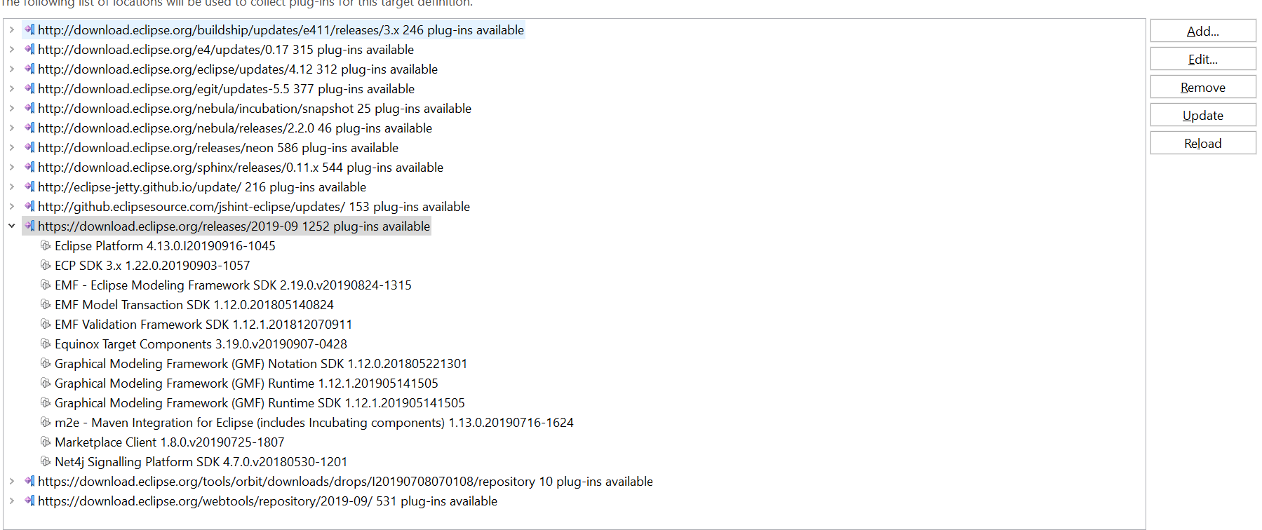

Re: No property tester contributes a property org.eclipse.emf.ecp.core.project.open [message #1816896 is a reply to message #1816894] Mon, 11 November 2019 06:28 Go to previous messageGo to next message

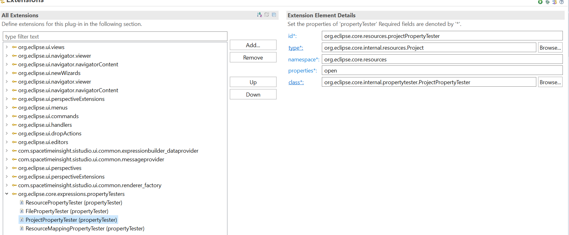

Actually in my target platform the attached screenshot updatesite urls used and installed ECP properly
can you please let me know which plugin is required to add into the my targetplatform ?
and
which entry required need to add into my plugin.xml ?
i added like the above but it is not working , can you please send me the sample entry
