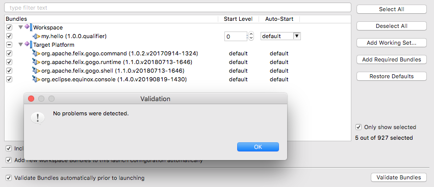

(1) With the following run configuration, I am able to execute the simple OSGi application and interact with it using the console:
index.php/fa/36728/0/
However, although the configuration comprises only a few bundles, a large number of OSGi bundles seems to be executed:

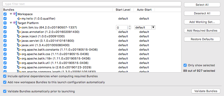

(2) As shown in the above figure, Eclipse considers this a "valid" configuration. However, if I click the "Add Required Bundles" button in the dialog, Eclipse adds a large amount of bundles to the configuration:
index.php/fa/36729/0/
It also does this with the "Include optional dependencies..." option disabled. I am also unable to understand how Eclipse calculates these dependencies. Where are they drawn from? Some of these dependencies causes the application to output messages like the following:
!ENTRY org.eclipse.equinox.registry 2 0 2019-11-08 01:11:39.795
!MESSAGE The extensions and extension-points from the bundle "org.eclipse.emf.validation.ui.ide.source" are ignored. The bundle is not marked as singleton.
Is it possible to configure Eclipse sucht that it adds only the bundles that are actually necessary?

Unfortunately, the "sources" bundles are not listed in the "Bundles" tab of Run Configuration dialog. Is there maybe another location that I need to check?

Thank you for the hint. Taking a look at the plug-in dependency hierarchy of the "my.hello" bundle, I can see that the only listed dependency is "org.eclipse.osgi", which itself has a dependency on "org.eclipse.osgi.compatibility.state". Nevertheless, the "Add Required Bundles" button adds a large number of bundles to the run. Do you have any idea where Eclipse might get them from?
