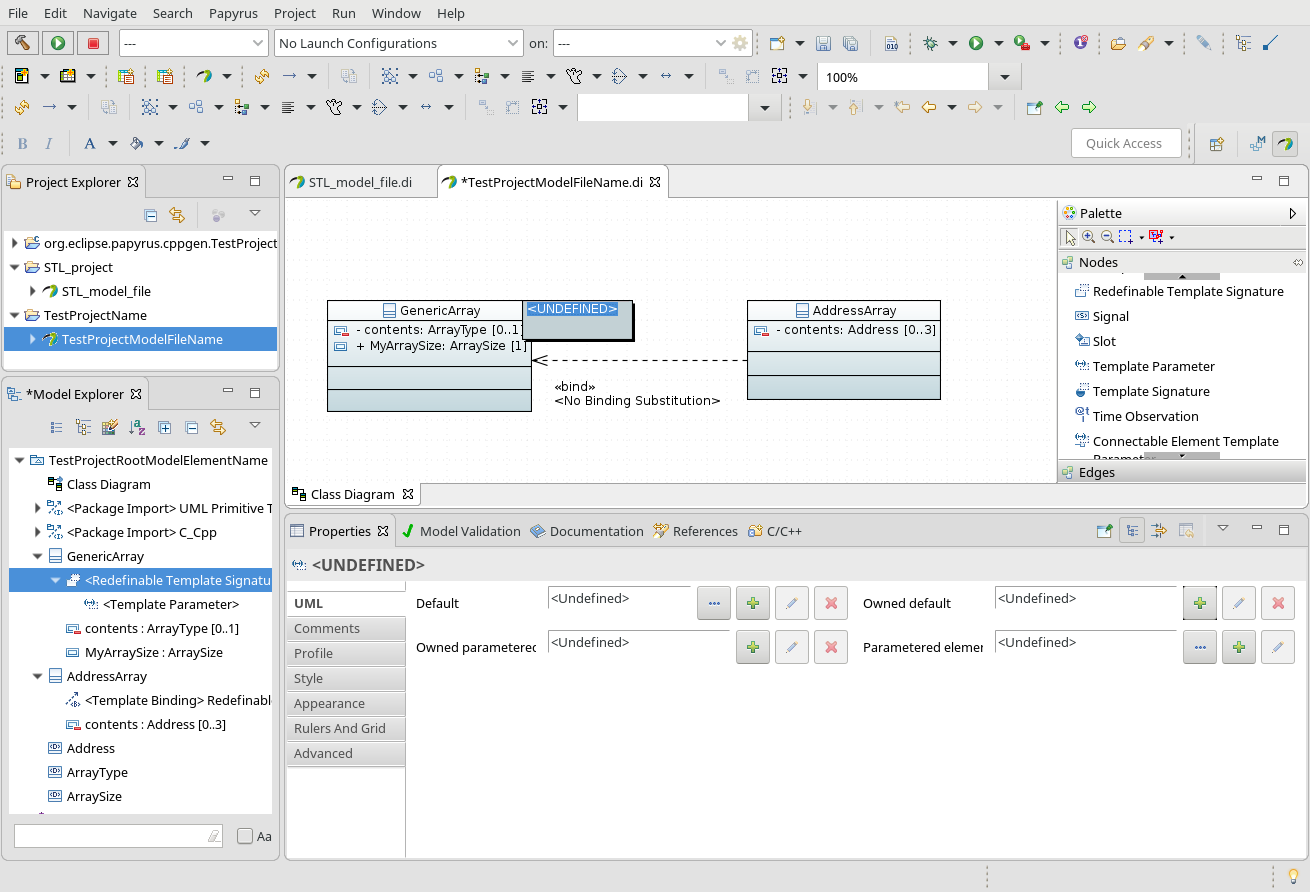

I've been struggling with understanding how to use templates in Papyrus so I found an example here https://docs.nomagic.com/display/MD190/Template and decided to attempt to recreate it in Papyrus.
I got stuck trying to add a Template Parameter to to a Redefinable Template signature.
index.php/fa/36727/0/
Para 7.3.3.2 says "A templateParameter is defined in terms of a ParameterableElement contained within the template that owns the TemplateSignature of which the TemplateParameter is a part."
OK, so I read that as saying that I need to add a ParameterableElement to my GenericArray template. Para 7.8.13.1 says "A ParameterableElement is an Element that can be exposed as a formal TemplateParameter for a template, or specified as an actual parameter in a binding of a template."
I take this to mean that any element can be a ParameterableElement once it is associated with a TemplateParameter. I added the property myArraySize to GenericArray and then attempted to set it as the Paramererized Element of the current Undefined Template Parameter but nothing appears to happen. There are no messages, warnings but the Template Parameter still says UNDEFINED.
Can someone point out where I'm going wrong here?

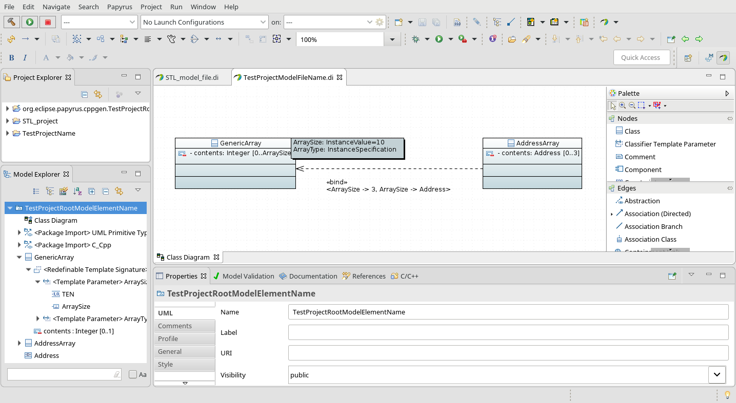

For my array example, I chose an InstanceValue for ArraySize and gave it a default of an IntegerLiteral = 10 and I chose an InstanceSpecification for ArrayType so my example now looks like this.
index.php/fa/36772/0/
which I think is what I want.
Steve

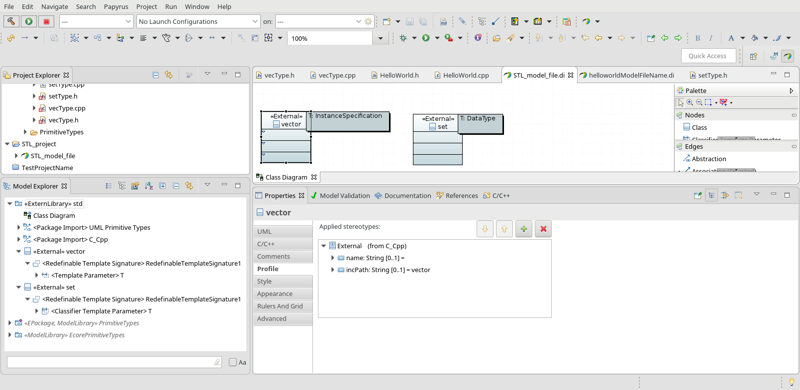

So I wanted to try to create an STL project that uses some parameterized type. I created a vector template class using a Template Parameter and a set template using a Classifier Template Parameter. I made the root element an ExternalLibrary and gave it a prefix of std. Like this:
index.php/fa/36777/0/

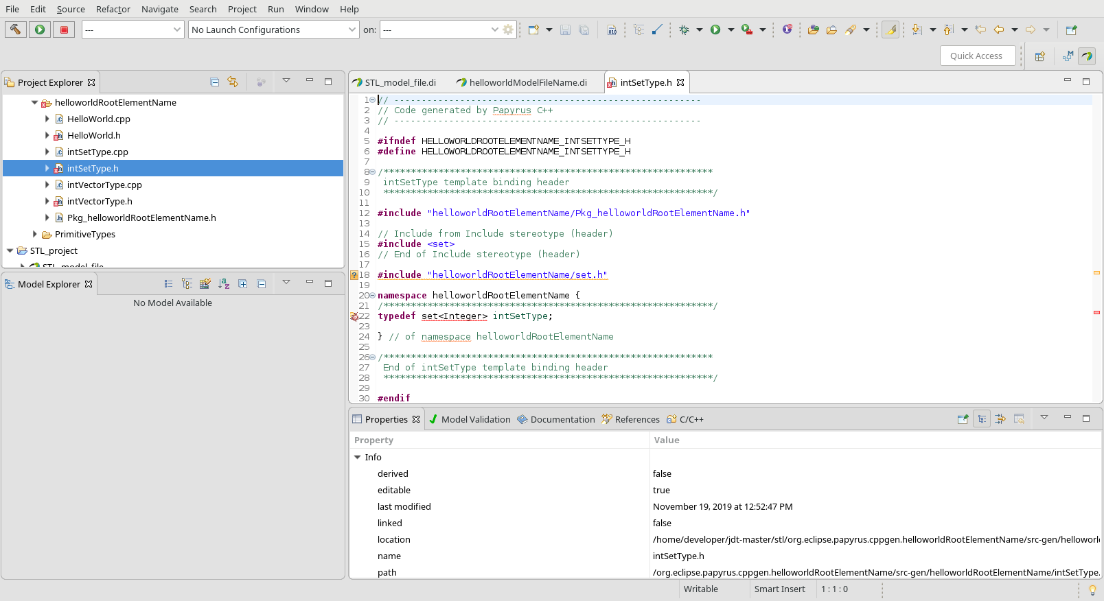

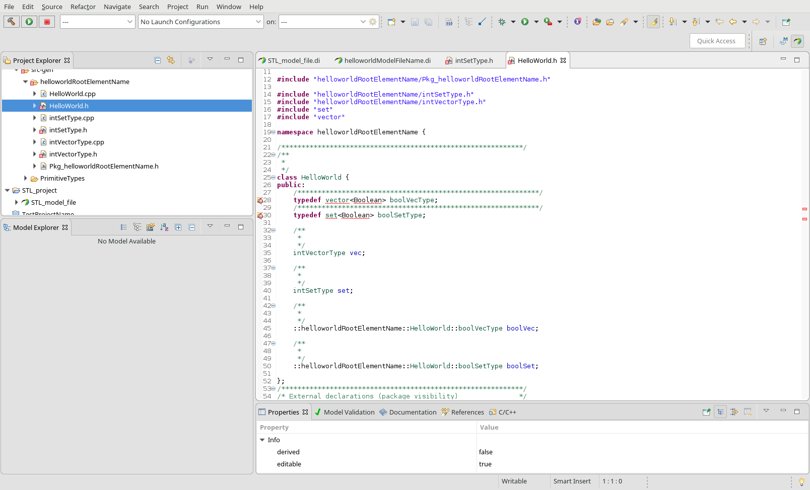

Then a created a couple of DataTypes to bind to the templates and creates a class with some properties of those bound DataTypes and generated the code. This didn't really work. Here is the code generated for my intSetType:
index.php/fa/36778/0/
First of all it the code tries to include a file called "helloworldRootElementName/set.h" that doesn't exist and second it tyies to typedef set<Integer> instead of std::set<Integer>. I could add "using namespace std;" to the stereotype header but that is not ideal.

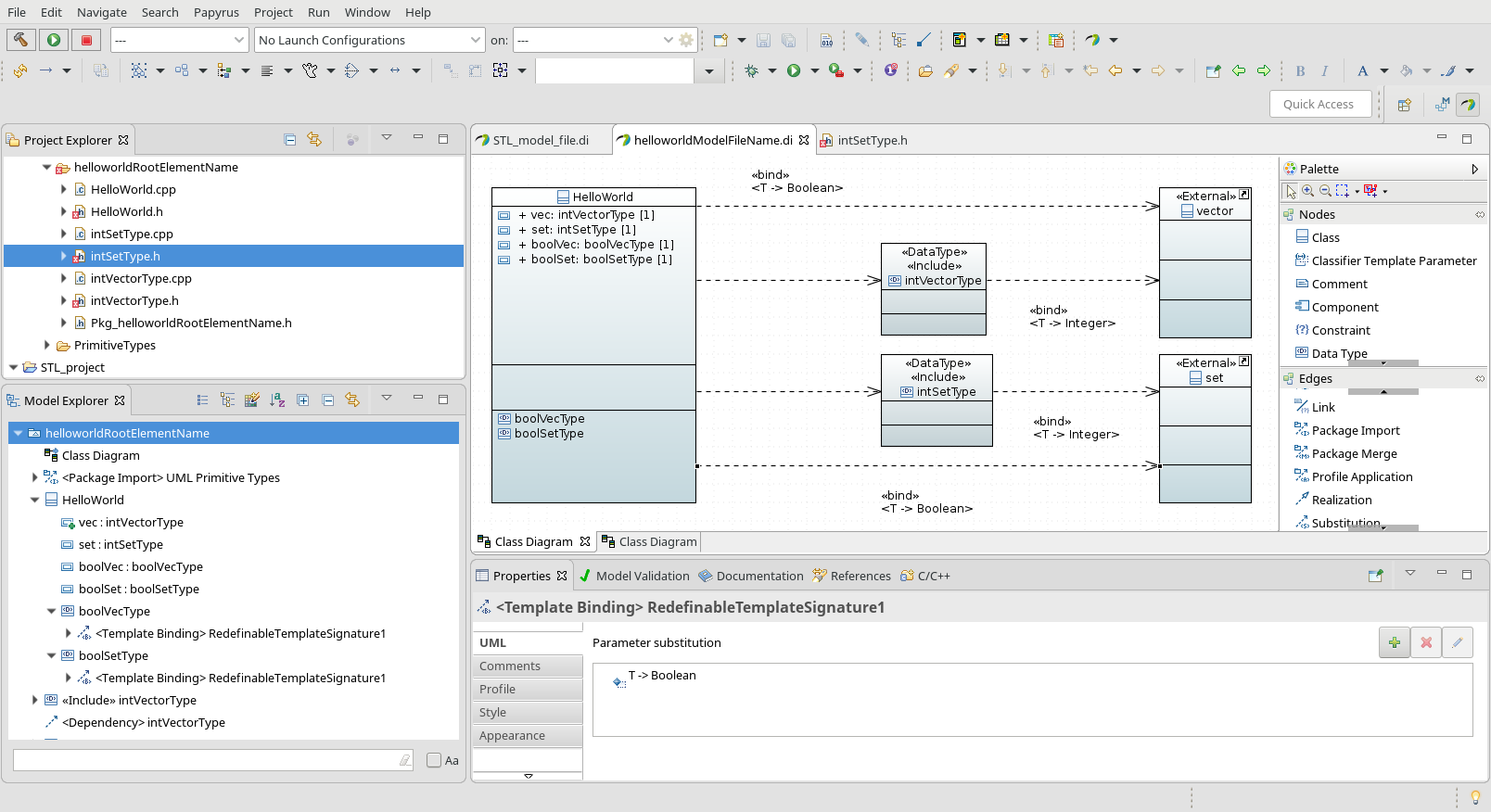

Next I decided to try to create a nested DataType to bind to the template like this:
index.php/fa/36780/0/
This looks more promising. Here is the .h file it generated:
index.php/fa/36781/0/
Any idea on how to get the std prefix to show up?
