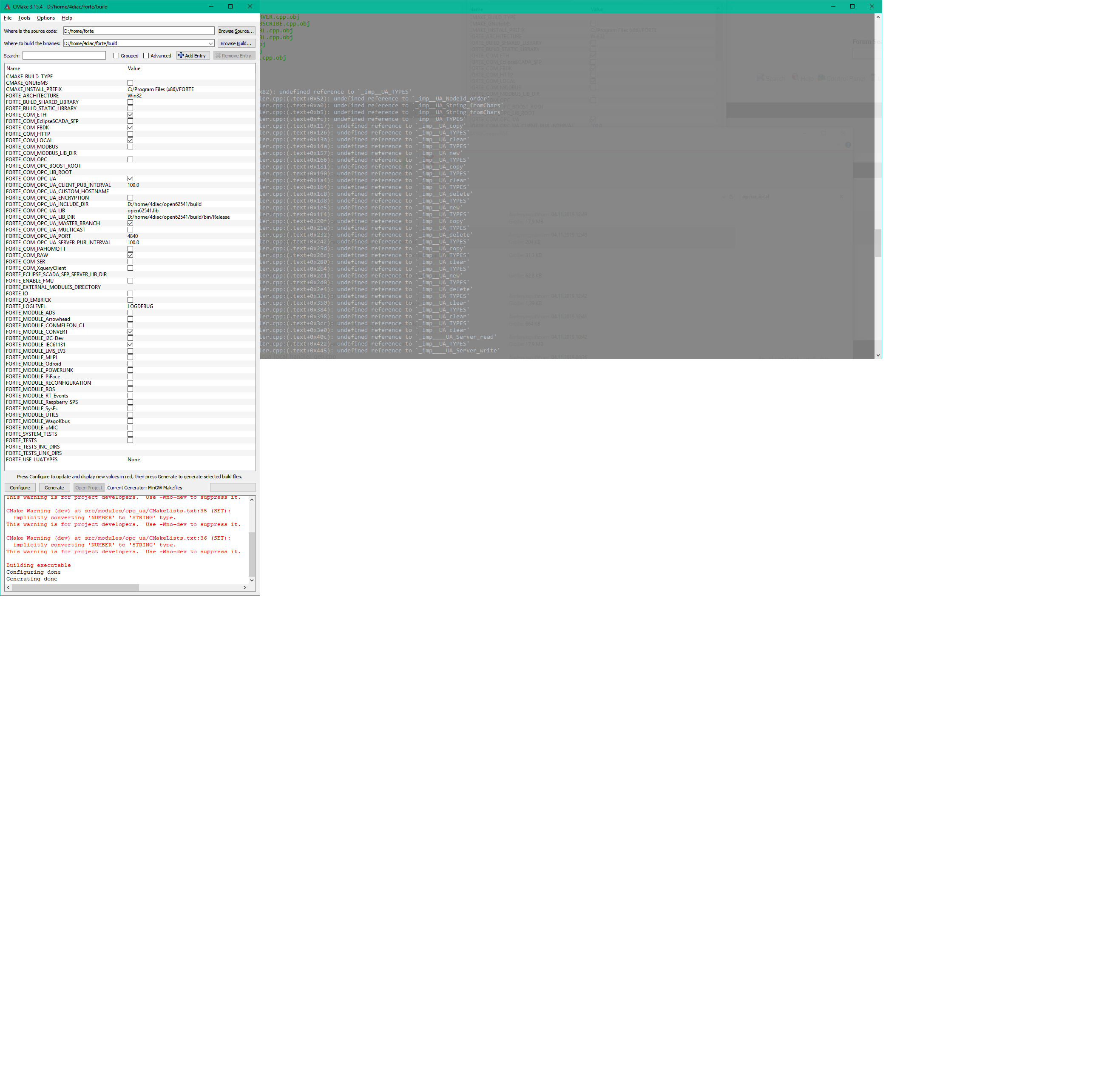

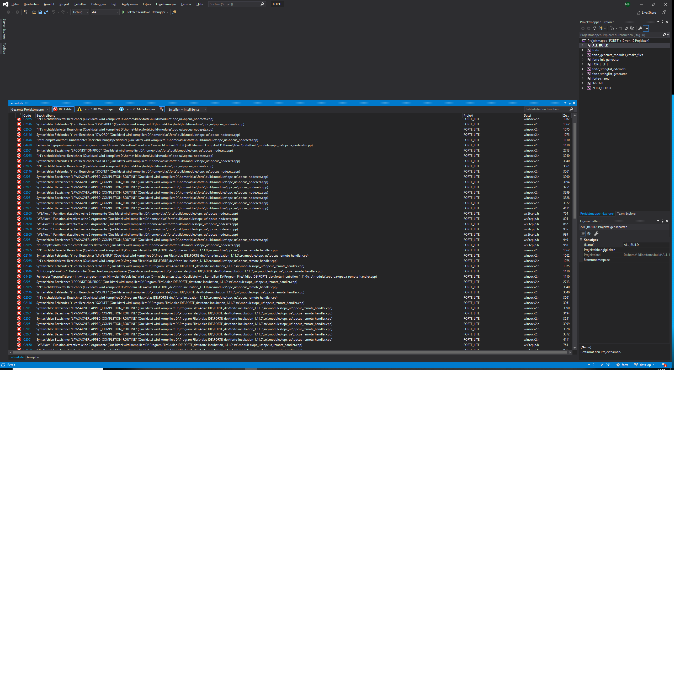

I followed the documentation about building forte for opc_ua and at step 14, I get stuck while compiling in VS2019. It seems to be the same error like in a previous post (https://www.eclipse.org/forums/index.php/m/1804974/?srch=opcua_handler#msg_1804974) but none of the suggested solutions seem to work.
as recommended here : https://www.eclipse.org/forums/index.php/m/1814445/?srch=forte+undeclared+in#msg_1814445

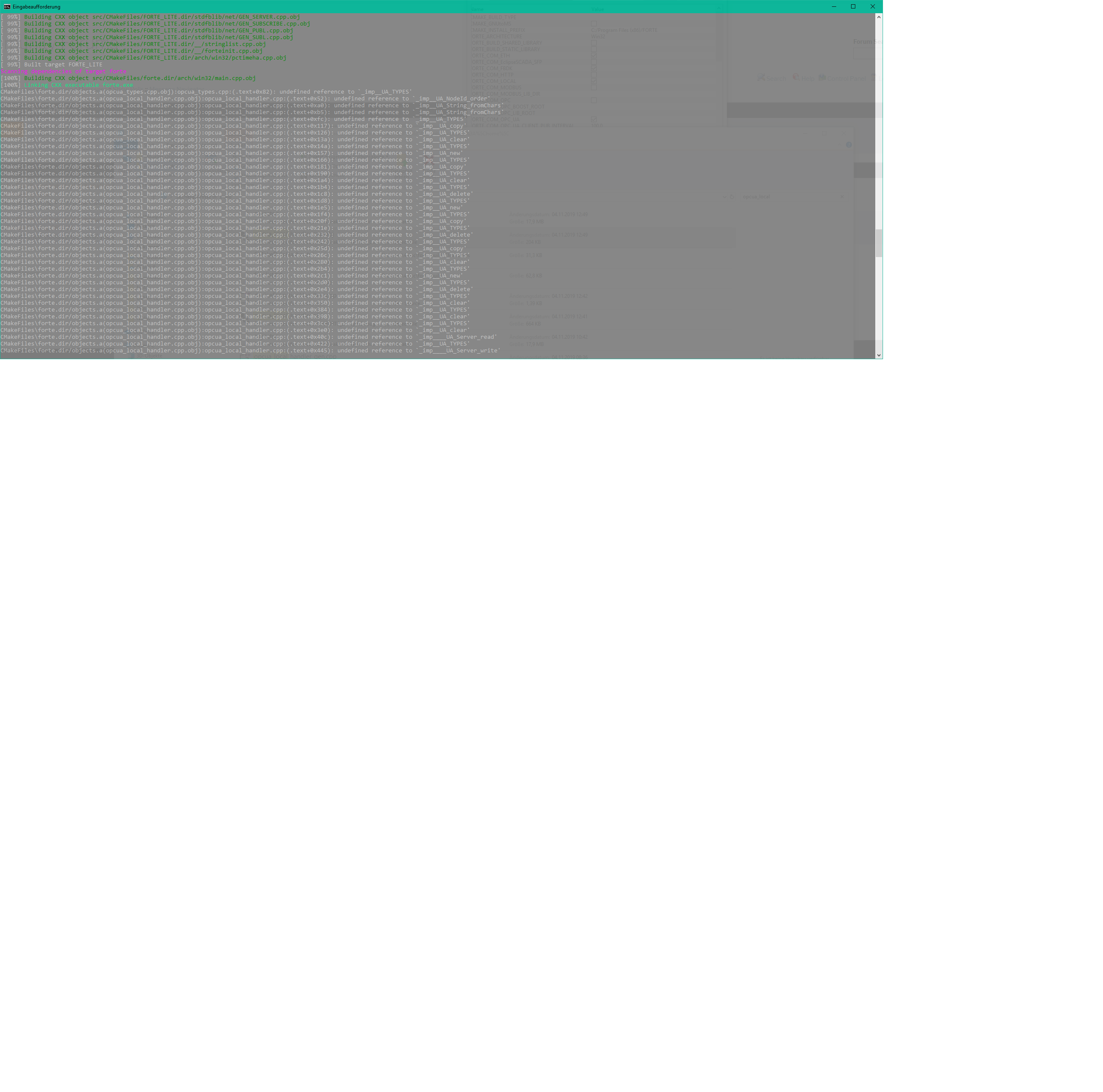

I used minGW as the compiler and it compiles fine until it tries to link the forte.exe
I attached some screenshots for better understanding my problem.
Is there something I am missing or doing wrong?

sorry for the problem with VS, that's some bigger issue that's not easy to solve for now.
regarding the issues you have with minGW I have some points:
- Try building your open62541 library also with mingw
- In the past we had issues with mingw but so we always tests with mingw-w64 (no, they are not the same https://sourceforge.net/projects/mingw-w64/)

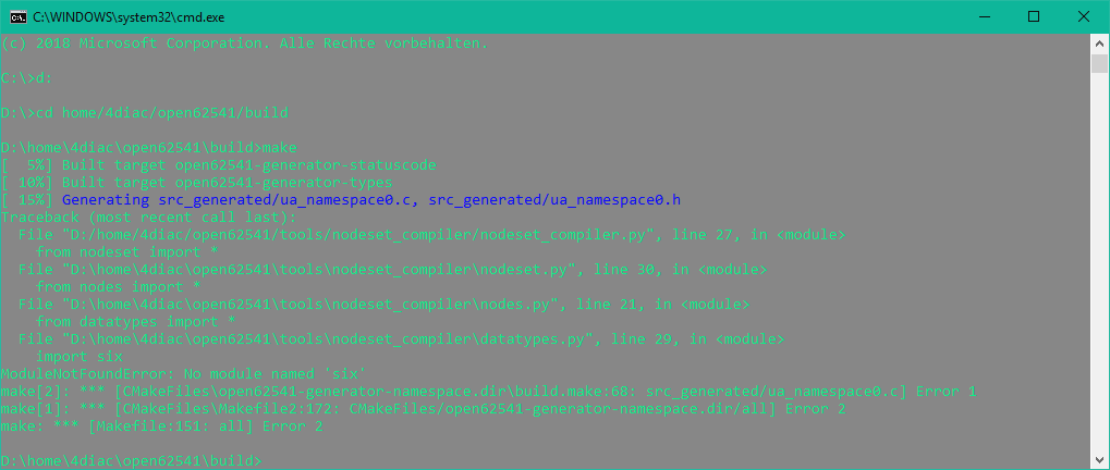

Now unfortunately there is a problem when trying to compile open62541. (see the screenshot)
I use the v0.3.0 branch like stated here: https://www.eclipse.org/4diac/documentation/html/communication/opc_ua.html
when configuring in CMake I use MinGWMakefiles as the generator and it automatically detects the compilers in the path of the mingw-w64 install.
configuring and generating works without problems but when trying to compile it shows this error.
p.s.: I would really like to continue working with 4diac as it fits my project perfectly and I would be very thankful if you could help me with this problem.
edit:
its working now after installing the module "six" for python
