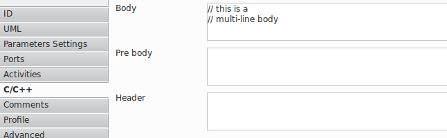

Btw, in addition to the C/C++ view, there is now (using the nightly update site for SW designer) also a C/C++ tab in the property view (see attached screenshot). but it only supports a subset of options that are available via the C/C++ view or the profile tab.
