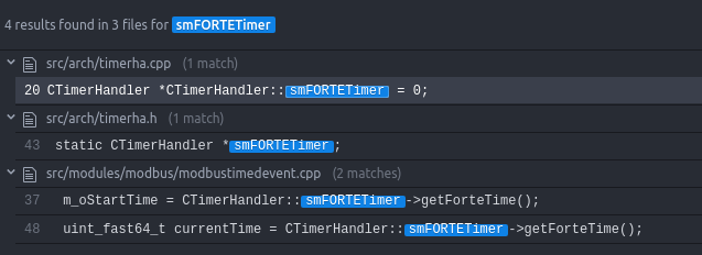

Have you added the DECLARE_HANDLER and DEFINE_HANDLER to CModbusHandler and added the handler with forte_add_handler in the according CMakeList.txt? You can hae a look at the serial handler for reference.
Re: Problems to compile FORTE+Modbus [message #1822792 is a reply to message #1822790] Fri, 13 March 2020 10:49 Go to previous messageGo to next message
Hey
Yes its declared in modbushandler.h and defined in modbuslayer.cpp. Also forte_add_handler(CModbusHandler modbushandler) in the CmakeLists.txt.
Can it be a problem related with the smFORTETimer that hasnt been initialized.
Searching the code only 4 results are found, see picture
  • Attachment: Untitled.png
    (Size: 26.61KB, Downloaded 112 times)
[Updated on: Fri, 13 March 2020 10:53] by Moderator
Re: Problems to compile FORTE+Modbus [message #1822793 is a reply to message #1822792] Fri, 13 March 2020 10:57 Go to previous messageGo to next message
smFORTETimer is gone for good. If you still have one than something is really wrong.

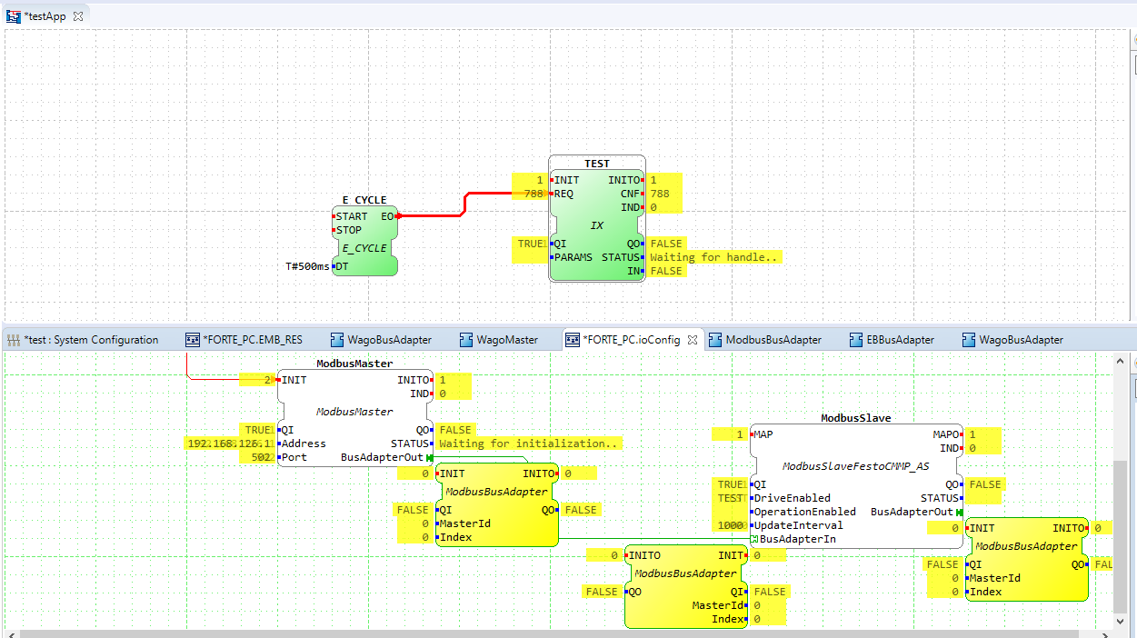

Re: Problems to compile FORTE+Modbus [message #1822874 is a reply to message #1822820] Mon, 16 March 2020 05:27 Go to previous messageGo to next message
Hey
I managed to get the modbus-ng source from the link you provided, compile it and made an basic interface for the modbus slave, then i configured it and download it to forte. It was a success, it managed to connect and request the MODBUS simulator the vendor name, product code and majorminor versions. Now the next question is, how do i map the modbus to the IO blocks?

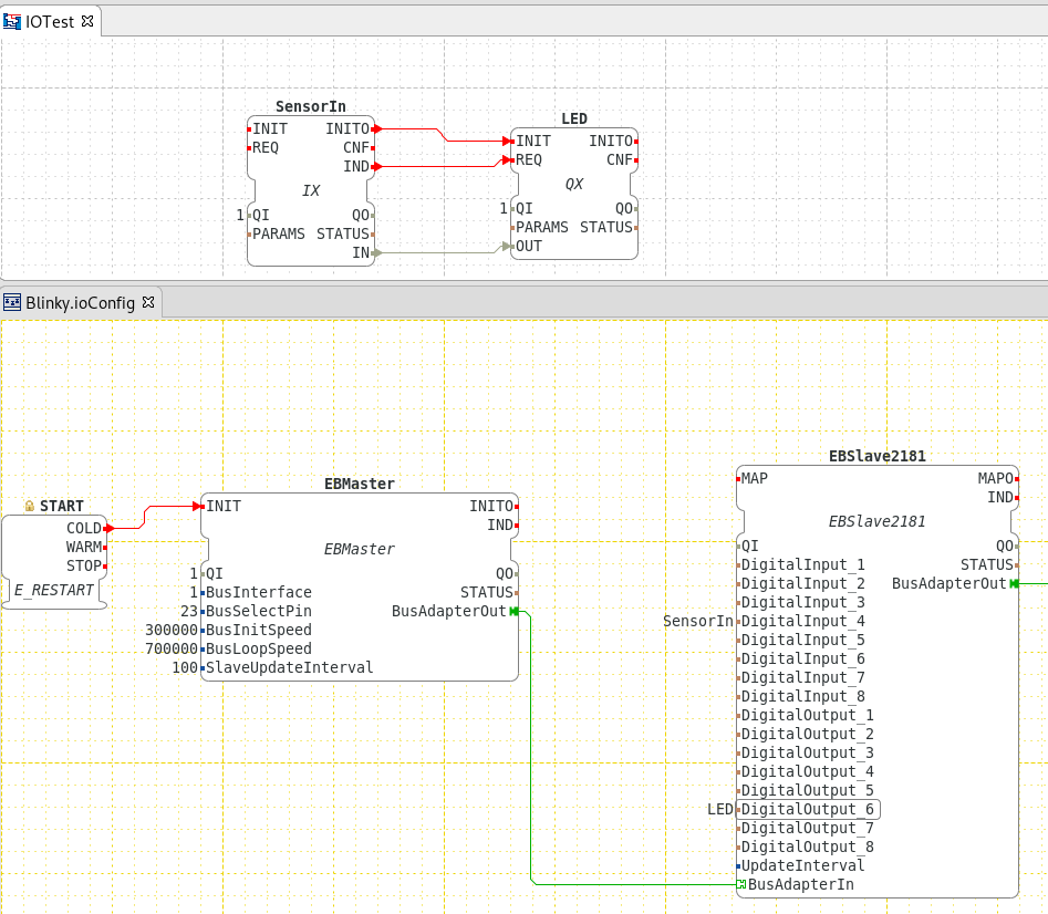

Re: Problems to compile FORTE+Modbus [message #1822884 is a reply to message #1822874] Mon, 16 March 2020 07:16 Go to previous messageGo to next message
hey these are great news. i really have to fix it and get it into the main git.
the idea of the new IO infrastructure is that the names you give the IO blocks are mapped to the IOs provide by the fieldbusses/IO subsystem. Therefore we can now separate better between IO configuration and application needs.
Your IO FBs for mod-bus should have a string input for each IO value they provide. Here you can specifiy the name of the IO FB used in your FB. During initialisation it should lead to an automatic mapping.
Re: Problems to compile FORTE+Modbus [message #1822955 is a reply to message #1822884] Tue, 17 March 2020 06:48 Go to previous messageGo to next message
Hey Alois.
Can you share an example? I'm not sure i understand exactly what i need todo.

Ah sorry for the little explanation. As this is a new concept we are still working on ramping stuff up.
i don't have the modbus fbs but I tried to show an example with the EMBrick system which works similar.
So first of all we have the IO System configuration separated from the IO usage. You can see this in my attached image with the bottom part a resource in my device where I configure the available physical IOs. The bus master defines things like the port, the scan cycle, etc. With the adapter connection you can specify which IO modules are connected on the bus. In my case the first IO module is a 8 digital in 8 digital output module. You can have more of these IO module FBs daisy chained. With that you tell the bus master what IO modules to expect and what data to read.
In your application (top part in my screenshot) you use the IO FBs that you are used to (e.g., IX, QX, IW). The big difference is that you are not useing the params input anymore. With the instance name of the FB you specifiy a symbolic name of your IO in the application.
In order to link both parts together you now have to give at the inputs of your IO module FB the according name. you can see this in my figure where i mapped the IX block SensorIn to the digital input #4 of my IO module and the QX block LED to the Digtial output 6.
I hope this clarifies a few things.

Hey Alois,
This makes alot more sense now. Thanks for the example.
Anyways I'm able to make the ModbusMaster FB, but looks like the code in FORTE is missing the ModbusSlave. If i look into the source file the Slave.h and cpp doesnt have the declaration like the Master.h file, defining the inputs and outputs of the FB. When uploading the code to the FORTE it complains that the FB doesnt exists.
<!-- 192.168.126.131:61499: ioConfig -->
<Request Action="CREATE" ID="14">
<FB Name="ModbusSlave" Type="ModbusSlave"/>
</Request>
<Response ID="14" Reason="UNSUPPORTED_TYPE"/>
I'm starting to think that Martin has defined the Modbus Slave on this https://git.eclipse.org/r/139744 merge request on not on the first one.

Hey Alois
I managed to copy the files from Festo and create a Slave device, but I'm unsure if this configuration is done correctly. As the modules are saying "Waiting for initialization.."
Also FORTE is reporting [IOMapper] Register observer TEST
index.php/fa/37609/0/

Re: Problems to compile FORTE+Modbus [message #1823056 is a reply to message #1823046] Wed, 18 March 2020 18:47 Go to previous messageGo to next message
This looks strange. Because the ModbusMaster should send events to the slave. however it could also be that the device needs to be addressed correctly. Maybe the code in the slave is very specific to the FEST CMMP drive. With what device do you like to communicate?
Re: Problems to compile FORTE+Modbus [message #1823081 is a reply to message #1823056] Thu, 19 March 2020 04:36 Go to previous messageGo to next message
Hey I'm using diagslave 3.2 - FieldTalk(tm) Modbus(R) Diagnostic Slave Simulator, that handles all message. I can see when i download the configuration to forte that the forte requests the diagslave some Vendor PRodCod etc.
What i think is really strange is the STATUS on the master saying waiting initialization and also that the Adapter is not being initialized.
validateMasterIpAddr: accepting connection from 192.168.126.135
Slave 0: readDeviceIdentification VendorName
Slave 0: readDeviceIdentification ProductCode
Slave 0: readDeviceIdentification MajorMinorRevision
Re: Problems to compile FORTE+Modbus [message #1823095 is a reply to message #1823081] Thu, 19 March 2020 09:23 Go to previous messageGo to next message
Hey
I have been debugging and trying to understand how the FORTE code works. From my understanding the IOConfigFBMultiMaster::onStartup() is not being called. I'm unable to understand or find where this function shall be called.
Any ideas?
