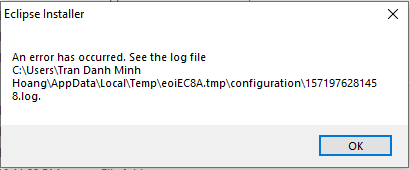

index.php/fa/36636/0/I install ECLIPSE and there is an announce error window. I open file follow announce error of that window. But i don't understand content that file. Can you explain me and help me install ECLIPSE. Thanks
Note:
I installed jdk-11.0.5
OS: Windows 10 pro 64 bit.

Very strange. I tried to reproduce this problem, so I downloaded this installer (for the current latest release):
https://www.eclipse.org/downloads/download.php?file=/oomph/epp/2019-09/R/eclipse-inst-win64.exe
Then I downloaded JDK 11.0.5 and I ran the installer like this (from a bash shell) to use exactly JDK 11.0.5:
./eclipse-inst-win64\(39\).exe -vm "C:/Program Files/Java/jdk-11.0.5/bin/javaw.exe"
But that starts fine for me. I'm in Windows 7 Pro, but I don't think that should make a difference...
The following installer is slightly newer so there's a chance that this might work better (though I doubt it):
http://www.eclipse.org/downloads/download.php?file=/oomph/products/eclipse-inst-win64.exe
It's also possible that Windows Defender is blocking something.
Alternatively you could also try to download and unzip a package from this page:
And hope that running the IDE itself doesn't fail the same way as the installer fails, but it seems likely to fail the same way...

i find to folder follow alert have extension .tmp. After that i install file eclipse-inst.exe again and then i success
