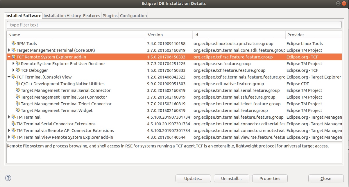

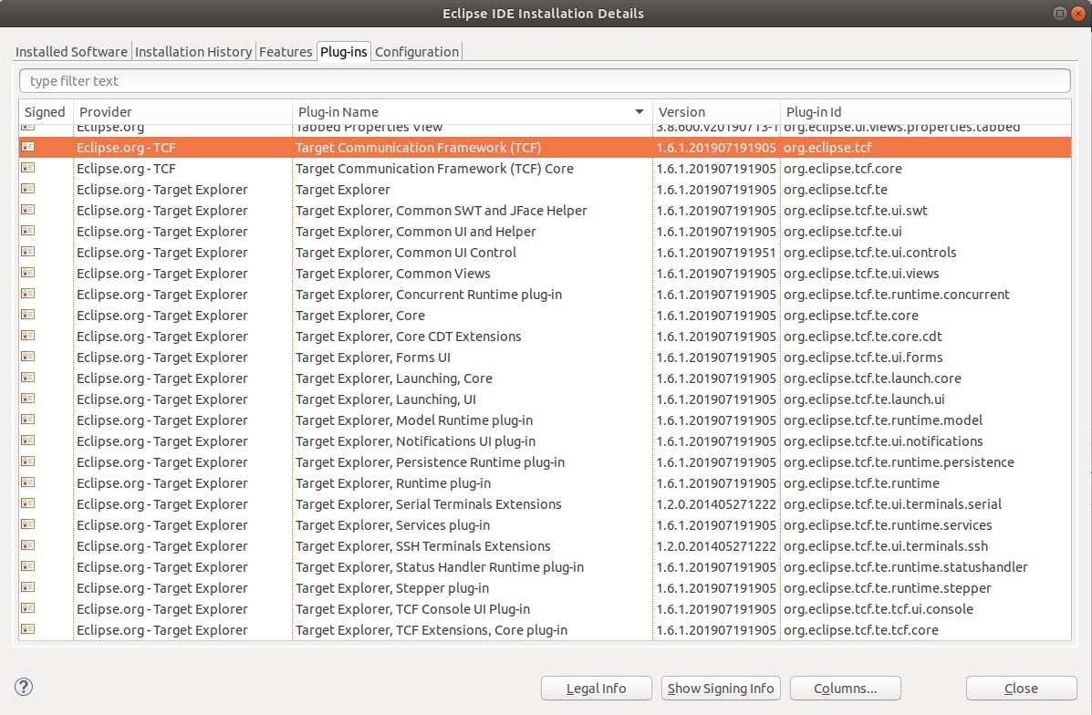

I want to say right away that I just started studying Linux and just installed the Eclipse Version: 2019-09 R (4.13.0) Build id: 20190917-1200.

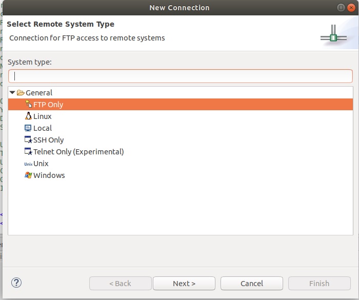

I created a simple Hello World project and I want to run the resulting application on the target platform. For this, For this I want to use Remote Systems Explorer. When creating a new connection, I do not find the TCF in the dialog. TCF plugin installed. What am I doing wrong? And how to return this type of connection?
See pictures below.

A while ago RSE changed owners and went though a period of instability. As result, Eclipse 2019-09 does NOT include TCF RSE add-on. However, it is available if you use latest RSE and TCF repositories:
https://download.eclipse.org/tm/updates/4.5.102-SNAPSHOT/repository/
https://download.eclipse.org/tools/tcf/builds/development/nightly/
Add those repos in Available Software Sites, do update, and it should work after that.
