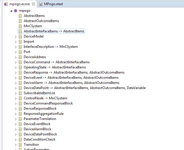

I am not sure, if I have correctly understood the word "identifiers" you are referring to. I assume that identifiers are Ecore classes which are used/referred in resources while defining the specifications.
Here is the sample Ecore model and the resource file (runtime).

In the above code, if I add new command in between or at start then differences generated are more than actual. Similarly for delete as explained in above comment.
