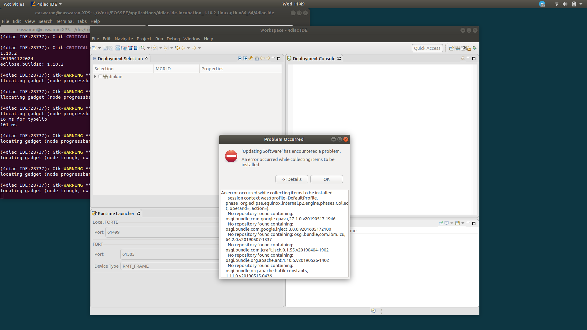

I am unable to update my 4diac IDE via Hep-->Check for Updates. My current version is 1.10.2 and would like to update it to 1.11.0. Has anyone faced similar errors?? I have attached relevant screenshots and log here. I don't have network issues and have tried to update in two different networks too.
My operating system is Ubuntu 18.04.3

Thanks for the information. I've seen this once in a while but I could not find the cause. I think the only workaround is to download the 1.11.0 version and unzip over your old version.
While I'm typing I just notice one further thing: with the update to the latest Eclipse platform we are not supporting 32bit versions anymore. So if you have a 32bit 4diac IDE Then you anyhow need to update manually.
Re: Error updating 4diac IDE [message #1816014 is a reply to message #1816000] Thu, 17 October 2019 04:53 Go to previous messageGo to next message
Interesting. When I did a Google search before posting this, I did get similar results from different projects and instances. I am guessing this has been an issue with eclipse IDE in general for sometime now.
Regarding the architecture, I have x86_64 and not 32bit. For the time being I will do the easy fix you suggested.
Thanks!
Re: Error updating 4diac IDE [message #1816016 is a reply to message #1816014] Thu, 17 October 2019 06:24 Go to previous message
I think it is something about how we generate the update site. If anybody has time to look into that it would be great.
