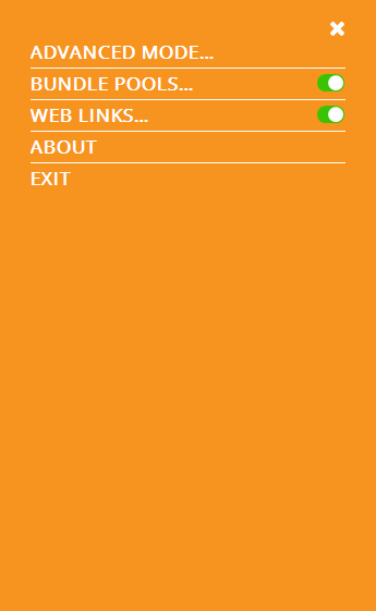

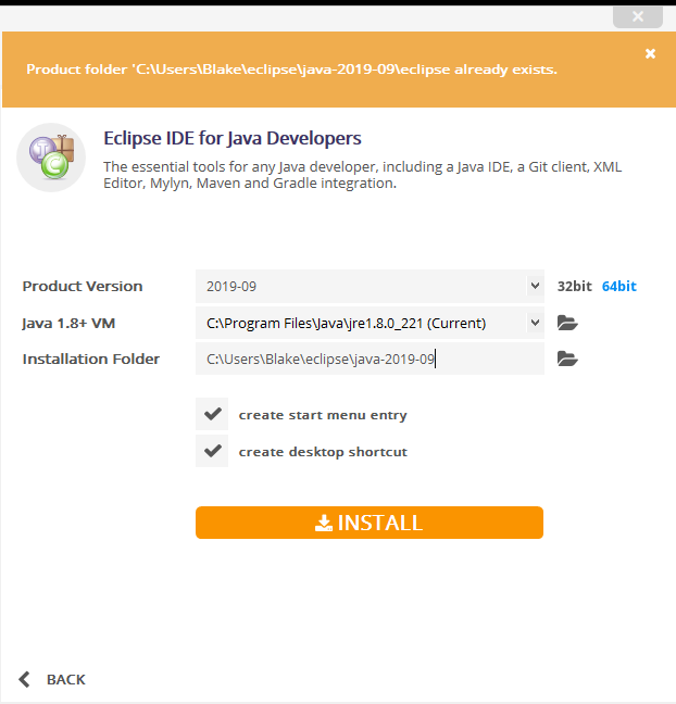

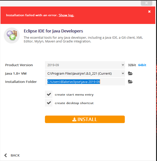

I've tried running it in Administrator mode, enabling web links, and that's about it. I keep getting this error log.
[2019-10-13 00:03:17] Executing bootstrap tasks
[2019-10-13 00:03:17] Java(TM) SE Runtime Environment 1.8.0_221-b11
[2019-10-13 00:03:17] Product org.eclipse.products.epp.package.java.2019-09
[2019-10-13 00:03:17] Bundle org.eclipse.oomph.setup 1.15.0.v20191006-0741, build=4318, branch=ba91f5da57169828df2f16c109932fbd886cdd4f
[2019-10-13 00:03:17] Bundle org.eclipse.oomph.setup.core 1.15.0.v20191006-0741, build=4318, branch=ba91f5da57169828df2f16c109932fbd886cdd4f
[2019-10-13 00:03:17] Bundle org.eclipse.oomph.setup.p2 1.13.0.v20190920-0437, build=4318, branch=ba91f5da57169828df2f16c109932fbd886cdd4f
[2019-10-13 00:03:17] Performing P2 Director (Eclipse IDE for Java Developers (2019-09))
[2019-10-13 00:03:17] Offline = false
[2019-10-13 00:03:17] Mirrors = true
[2019-10-13 00:03:17] Resolving 23 requirements from 3 repositories to C:\Users\Blake\eclipse\java-2019-09\eclipse
[2019-10-13 00:03:17] Requirement epp.package.java [4.13.0,5.0.0)
[2019-10-13 00:03:17] Requirement org.eclipse.platform.feature.group [4.13.0,5.0.0)
[2019-10-13 00:03:17] Requirement org.eclipse.rcp.feature.group [4.13.0,5.0.0)
[2019-10-13 00:03:17] Requirement org.eclipse.buildship.feature.group
[2019-10-13 00:03:17] Requirement org.eclipse.eclemma.feature.feature.group
[2019-10-13 00:03:17] Requirement org.eclipse.egit.feature.group
[2019-10-13 00:03:17] Requirement org.eclipse.egit.mylyn.feature.group
[2019-10-13 00:03:17] Requirement org.eclipse.epp.mpc.feature.group
[2019-10-13 00:03:17] Requirement org.eclipse.jdt.feature.group
[2019-10-13 00:03:17] Requirement org.eclipse.jgit.feature.group
[2019-10-13 00:03:17] Requirement org.eclipse.m2e.feature.feature.group
[2019-10-13 00:03:17] Requirement org.eclipse.m2e.logback.feature.feature.group
[2019-10-13 00:03:17] Requirement org.eclipse.mylyn.bugzilla_feature.feature.group
[2019-10-13 00:03:17] Requirement org.eclipse.mylyn.context_feature.feature.group
[2019-10-13 00:03:17] Requirement org.eclipse.mylyn.git.feature.group
[2019-10-13 00:03:17] Requirement org.eclipse.mylyn.hudson.feature.group
[2019-10-13 00:03:17] Requirement org.eclipse.mylyn.ide_feature.feature.group
[2019-10-13 00:03:17] Requirement org.eclipse.mylyn.java_feature.feature.group
[2019-10-13 00:03:17] Requirement org.eclipse.mylyn.wikitext_feature.feature.group
[2019-10-13 00:03:17] Requirement org.eclipse.mylyn_feature.feature.group
[2019-10-13 00:03:17] Requirement org.eclipse.tips.feature.feature.group
[2019-10-13 00:03:17] Requirement org.eclipse.wst.xml_ui.feature.feature.group
[2019-10-13 00:03:17] Requirement org.eclipse.oomph.setup.feature.group
[2019-10-13 00:03:17] Repository http://download.eclipse.org/technology/epp/packages/2019-09
[2019-10-13 00:03:17] Repository http://download.eclipse.org/releases/2019-09/201909181001
[2019-10-13 00:03:17] Repository http://download.eclipse.org/oomph/updates/milestone/latest
[2019-10-13 00:03:18] Calculating requirements and dependencies.
[2019-10-13 00:03:19] Computing prerequisite plan
[2019-10-13 00:03:20] Collecting 1 artifacts from http://download.eclipse.org/technology/epp/packages/2019-09
[2019-10-13 00:03:20] Downloading epp.package.java.executable.win32.win32.x86_64
[2019-10-13 00:03:20] Collected 1 artifacts for http://download.eclipse.org/technology/epp/packages/2019-09 in 0.293s
[2019-10-13 00:03:20] Collecting 3 artifacts from http://download.eclipse.org/releases/2019-09/201909181001
[2019-10-13 00:03:20] Downloading org.eclipse.platform_root
[2019-10-13 00:03:20] Downloading org.eclipse.platform.ide.executable.win32.win32.x86_64
[2019-10-13 00:03:20] Downloading org.eclipse.rcp_root
[2019-10-13 00:03:20] Collected 3 artifacts for http://download.eclipse.org/releases/2019-09/201909181001 in 0.345s
[2019-10-13 00:03:21] An error was detected while performing the engine operation and the changes are being rolled back. See the log for details.
[2019-10-13 00:03:21] ERROR: org.eclipse.equinox.p2.engine code=4 An error occurred during the org.eclipse.equinox.internal.p2.engine.phases.CheckTrust phase.
  at org.eclipse.oomph.util.OomphPlugin.coreException(OomphPlugin.java:280)
  at org.eclipse.oomph.p2.internal.core.ProfileTransactionImpl$3.commit(ProfileTransactionImpl.java:548)
  at org.eclipse.oomph.p2.internal.core.ProfileTransactionImpl.commit(ProfileTransactionImpl.java:340)
  at org.eclipse.oomph.setup.p2.impl.P2TaskImpl.perform(P2TaskImpl.java:758)
  at org.eclipse.oomph.setup.internal.core.SetupTaskPerformer.doPerformNeededSetupTasks(SetupTaskPerformer.java:3827)
  at org.eclipse.oomph.setup.internal.core.SetupTaskPerformer.performNeededSetupTasks(SetupTaskPerformer.java:3755)
  at org.eclipse.oomph.setup.internal.core.SetupTaskPerformer.performTriggeredSetupTasks(SetupTaskPerformer.java:3736)
  at org.eclipse.oomph.setup.internal.core.SetupTaskPerformer.perform(SetupTaskPerformer.java:3629)
  at org.eclipse.oomph.setup.internal.installer.SimpleVariablePage.installPerform(SimpleVariablePage.java:1305)
  at org.eclipse.oomph.setup.internal.installer.SimpleVariablePage.access$32(SimpleVariablePage.java:1167)
  at org.eclipse.oomph.setup.internal.installer.SimpleVariablePage$20.run(SimpleVariablePage.java:1112)
  ERROR: org.eclipse.equinox.p2.engine code=0 session context was:(profile=C__Users_Blake_eclipse_java-2019-09_eclipse, phase=org.eclipse.equinox.internal.p2.engine.phases.CheckTrust, operand=, action=).
  ERROR: org.eclipse.equinox.p2.engine code=0 Error reading signed content.
  java.io.IOException: Exception in opening zip file: C:\Users\Blake\.p2\pool\plugins\org.eclipse.draw2d_3.10.100.201606061308.jar
    at org.eclipse.osgi.framework.util.SecureAction.getZipFile(SecureAction.java:340)
    at org.eclipse.osgi.internal.signedcontent.SignedBundleHook.getSignedContent(SignedBundleHook.java:217)
    at org.eclipse.equinox.internal.p2.engine.phases.CertificateChecker.checkCertificates(CertificateChecker.java:77)
    at org.eclipse.equinox.internal.p2.engine.phases.CertificateChecker.start(CertificateChecker.java:58)
    at org.eclipse.equinox.internal.p2.engine.phases.CheckTrust.completePhase(CheckTrust.java:55)
    at org.eclipse.equinox.internal.p2.engine.Phase.postPerform(Phase.java:255)
    at org.eclipse.equinox.internal.p2.engine.Phase.perform(Phase.java:105)
    at org.eclipse.equinox.internal.p2.engine.PhaseSet.perform(PhaseSet.java:50)
    at org.eclipse.equinox.internal.p2.engine.Engine.perform(Engine.java:80)
    at org.eclipse.equinox.internal.p2.engine.Engine.perform(Engine.java:48)
    at org.eclipse.equinox.internal.provisional.p2.director.PlanExecutionHelper.executePlan(PlanExecutionHelper.java:46)
    at org.eclipse.oomph.p2.internal.core.ProfileTransactionImpl$3.commit(ProfileTransactionImpl.java:544)
  Caused by: java.io.FileNotFoundException: C:\Users\Blake\.p2\pool\plugins\org.eclipse.draw2d_3.10.100.201606061308.jar (The system cannot find the file specified)
    at java.util.zip.ZipFile.open(Native Method)
    at java.util.zip.ZipFile.<init>(Unknown Source)
    at org.eclipse.osgi.framework.util.SecureAction.getZipFile(SecureAction.java:322)
    ... 1 more

You should not need to run as admin.
Like in this post, the question is, does the file its complaining about exist:
https://www.eclipse.org/forums/index.php/m/1780180/?srch=repair+bundle+pool#msg_1780180
As mentioned in that post, you can try repairing the pool if it's corrupt...

This was very helpful. I went into it, and I found where it gave me the option to repair the broken artifacts. Thank you for mentioning this.
