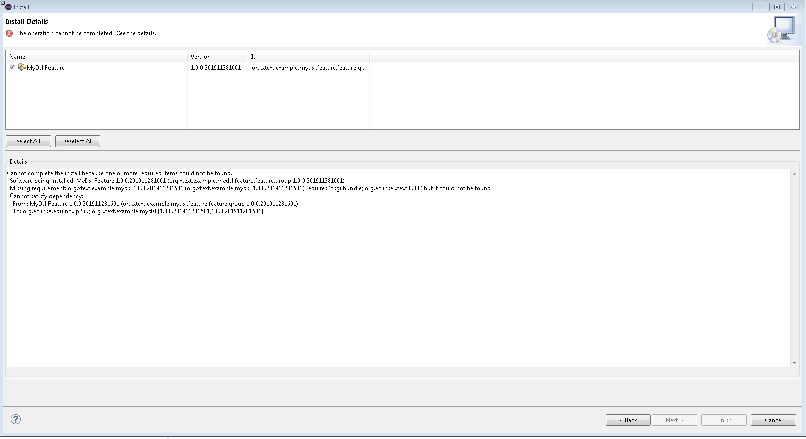

during installing my DSL, i am getting following failure:
Missing requirement: Equinox Provisioning UI Support 2.5.600.v20190814-1459 (org.eclipse.equinox.p2.ui 2.5.600.v20190814-1459) requires 'osgi.bundle; org.eclipse.e4.ui.dialogs 1.1.600' but it could not be found
i have created updatesite and added eclipse.e4.ui.dialogs as a included plugin but it doesn't help, could you give tips please?
Re: Testing code generation [message #1817749 is a reply to message #1817748] Thu, 28 November 2019 08:46 Go to previous messageGo to next message
- how do you install
- into which version do you install
- what updates sites are configured
- you should not have anything besides the mydsl plugins in the update site

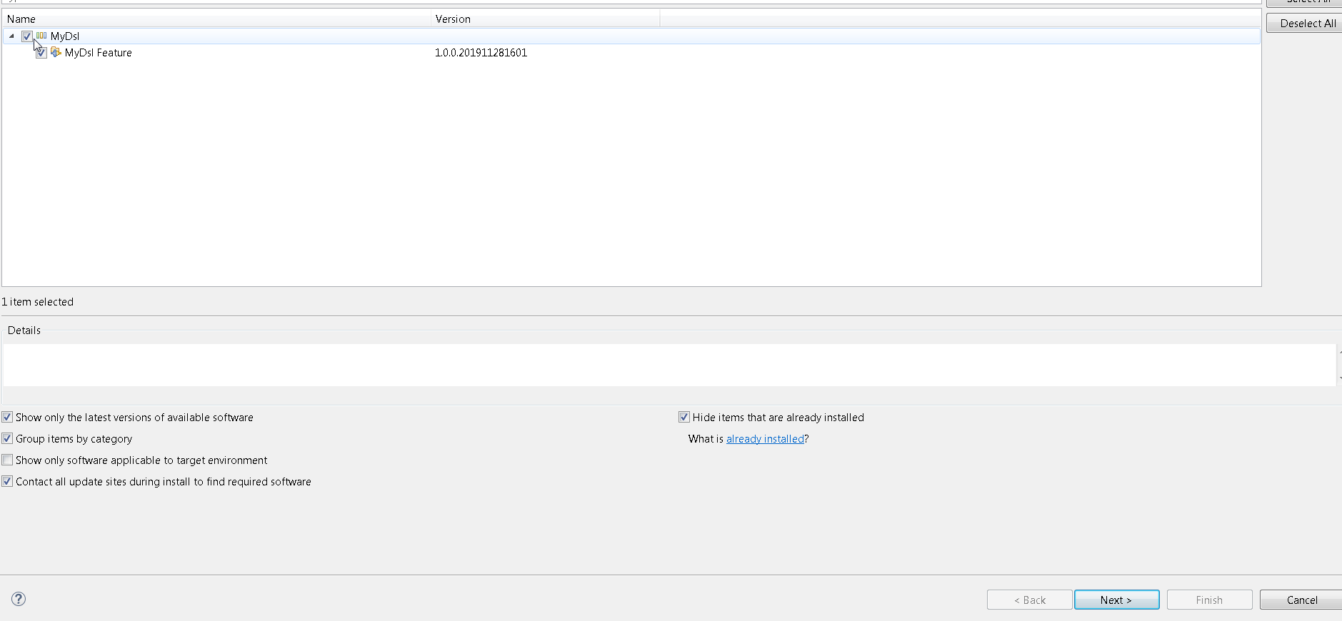

Re: Testing code generation [message #1817786 is a reply to message #1817760] Fri, 29 November 2019 01:57 Go to previous messageGo to next message
Thank you very much Christian, the problem is, MyDsl was created with eclipse version 2019-09( Dsl tools version) there are everything like xtext, emf and so on installed
but i want to install MyDsl plugin in eclipse version 2019-06 ( java version) , where i dont have any xtext, antlr ...
i can install my MyDsl plugin in eclipse version 2019-09(dsl tools) without any problem, but i can't install the same plugin in eclipse version 2019-06(java version)
to install this plugin ,
opened eclipse version 2019 -06 (java version)
choosed help-> install new software
in the "Work with" section clicked Add button , opened "Add repository" dialog and clicked Local
and selected directory of my updatesite, than appeared MyDsl
Re: Testing code generation [message #1817787 is a reply to message #1817786] Fri, 29 November 2019 02:01 Go to previous messageGo to next message

Still the questions
- what is the eclipse you install to.
- what is the update sites configured there
- did you add the Xtext update site there
- what changes did you do to what Xtext pregenerates
- what is the complete error message
Re: Testing code generation [message #1817799 is a reply to message #1817792] Fri, 29 November 2019 04:59 Go to previous messageGo to next message
- what is the eclipse you install to ->
Eclipse IDE for Java Developers Version: 2019-06 (4.12.0)
- what is the update sites configured there ->
how can i configure update sites in eclipse?
( in org.xtext.example.mydsl.target) or should I define it elsewhere?
-did you add the Xtext update site there -> do you mean in Eclipse?
In the eclipse where I instal mydsl, there is no xtext installed
Re: Testing code generation [message #1817801 is a reply to message #1817799] Fri, 29 November 2019 05:43 Go to previous messageGo to next message
no idea sure you dont have a bad behaving proxy?
