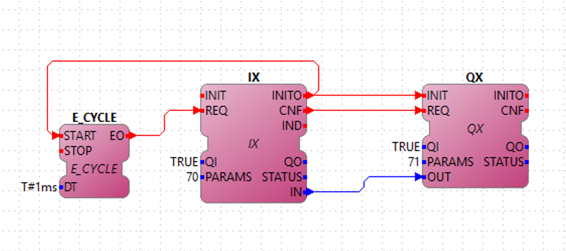

Hi, I have the simple project, which task is to read signals from GPIO Input and to write current state to GPIO Output (pic1.png).

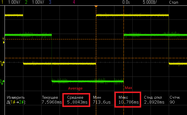

I launched this project on BeagleBone and Raspberry 3B+ on linux with and without Real-Time kernel "cover". Having cycle time equal 1 ms, I had delay between input and output signals about 5 ms in average and one time of thousands it was 10 ms (pic2.png).
The main goal is to achieve a delay of 5 milliseconds at maximum. Average delay must be less than this value.
How can this be fixed? And could you recommend which kernel configuration parameters I should change?
Explanation to pic2.png:
yellow - input signal
green - output signal

I had a look into the implementation of the sysfs IO interface. There I saw that it has an implementation of a scanning thread, which is updating the inputs with a scan-time of 10ms. See for reference line 235 in src/modules/sysfsprocint.cpp.
Currently this is unfortunately hardcoded. so the first thing what I would do for testing is to get this time down to 1ms. The second thing what you can do now is to use the IND output of your IX FB. This will trigger everytime the input changes. I hope with that you should be much faster.
If this is then still not sufficient I think the next step would be to look into other ways of accessing IOs on raspberryPis. then also the new IO design should be implemented. In that we can have more control on the scan cycles.
