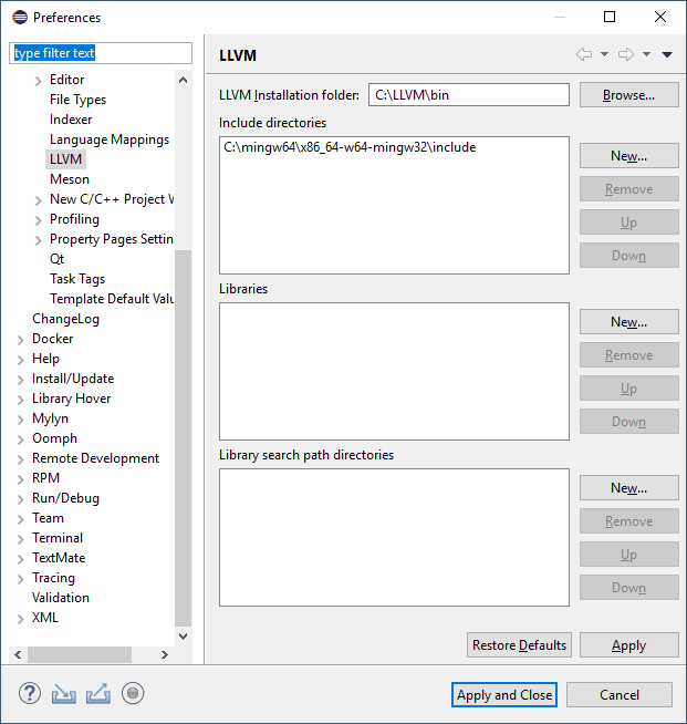

- In Preferences -> LLVM I've added C:\LLVM\bin as LLVM Installation folder and C:\mingw64\x86_64-w64-mingw32\include as Include directory (see Preferences_LLVM.png).
