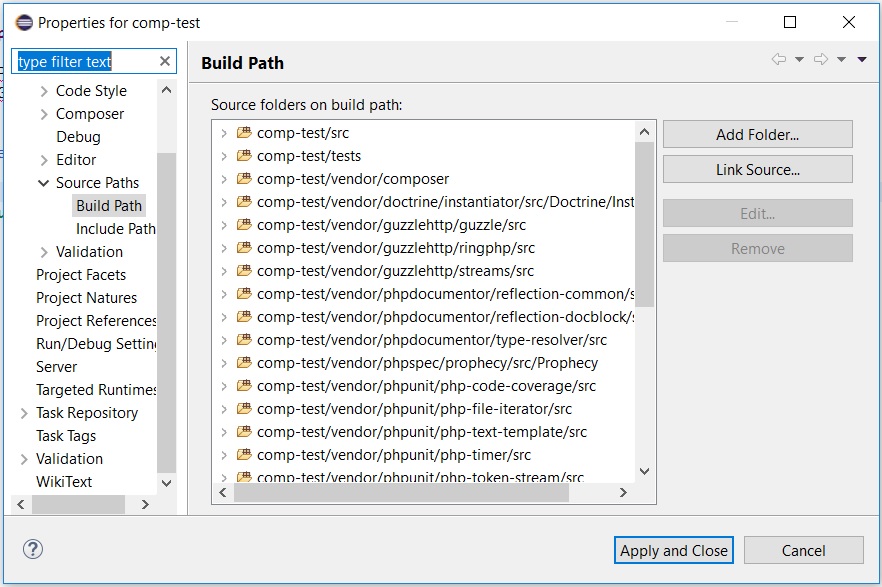

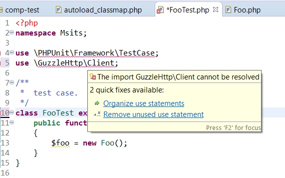

Hi all,
I can't get the Composer projects working. Hopefully somebody can point me in the right direction. I have created a Composer project with dependencies, which are downloaded and installed as expected. The src-folders are correctly added to the build path by the Composer Plug-in but Eclipse can't resolve any type or import I use from the dependencies. Therfore the autocpomletion does not work eighter.

Have You auto build enabled (default value in theory).
Try run in menu Project -> Clean and wait moment.
Re: Imports and types can't be resolved when a Composer project is created [message #1815509 is a reply to message #1815406] Thu, 03 October 2019 13:28 Go to previous message
"Project -> Clean" did not work, but "Composer -> Update Build Path" did the trick.
