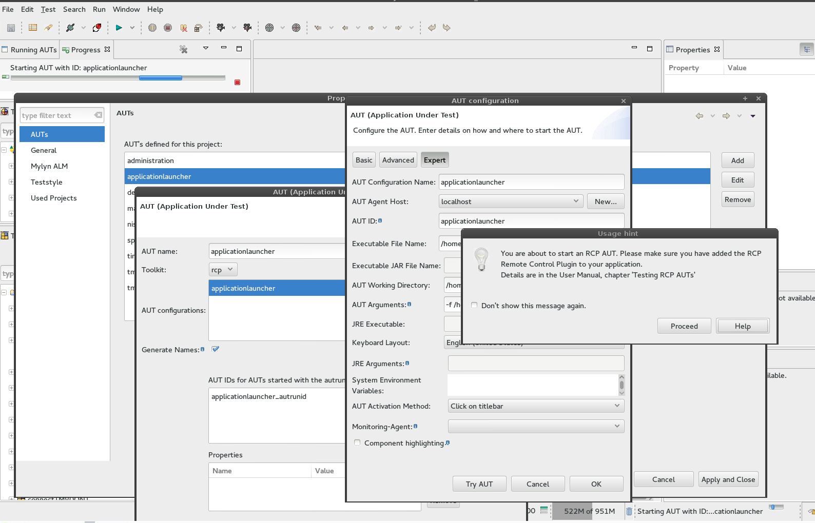

I created an AUT and I am trying to run through the 'Try AUT' button but it stucks on 'progress' forever ...
index.php/fa/36389/0/
As you can see the plugin is up&running
index.php/fa/36390/0/

You have not looked into your Application installation details, but into the Jubula ones. The selected bundles should be available in your Application! So the rc.rcp bundle must be installed into your application
