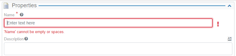

I'm referring to ECP (or what we now use that is derived from it)
See image with red star, indicating a required field and the red border here with the exclamation point and message below coming from the validator.
