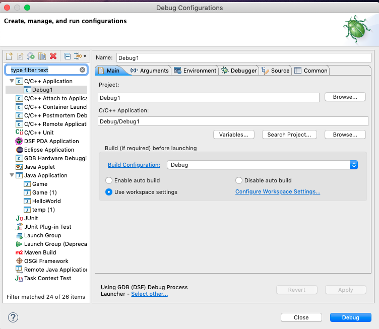

The Resume, Step into, Step Over buttons greyed out when I debug the C++ code. See the attachments. Please help.

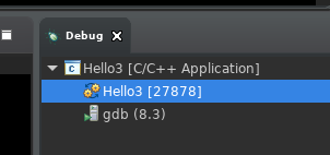

Normally (at least for me), the Debug view expands the running task
index.php/fa/36348/0/

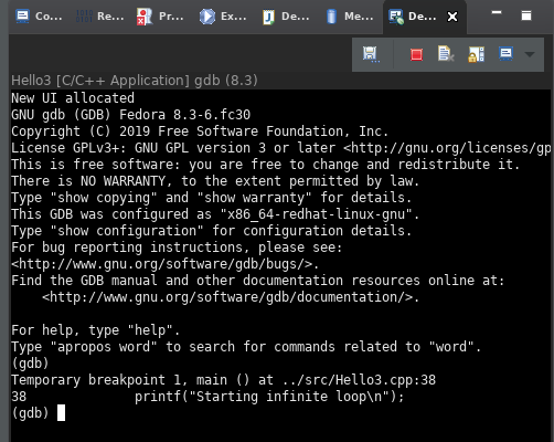

There's a view called Debugger Console which lets you see what's happening.
For example,
index.php/fa/36349/0/
