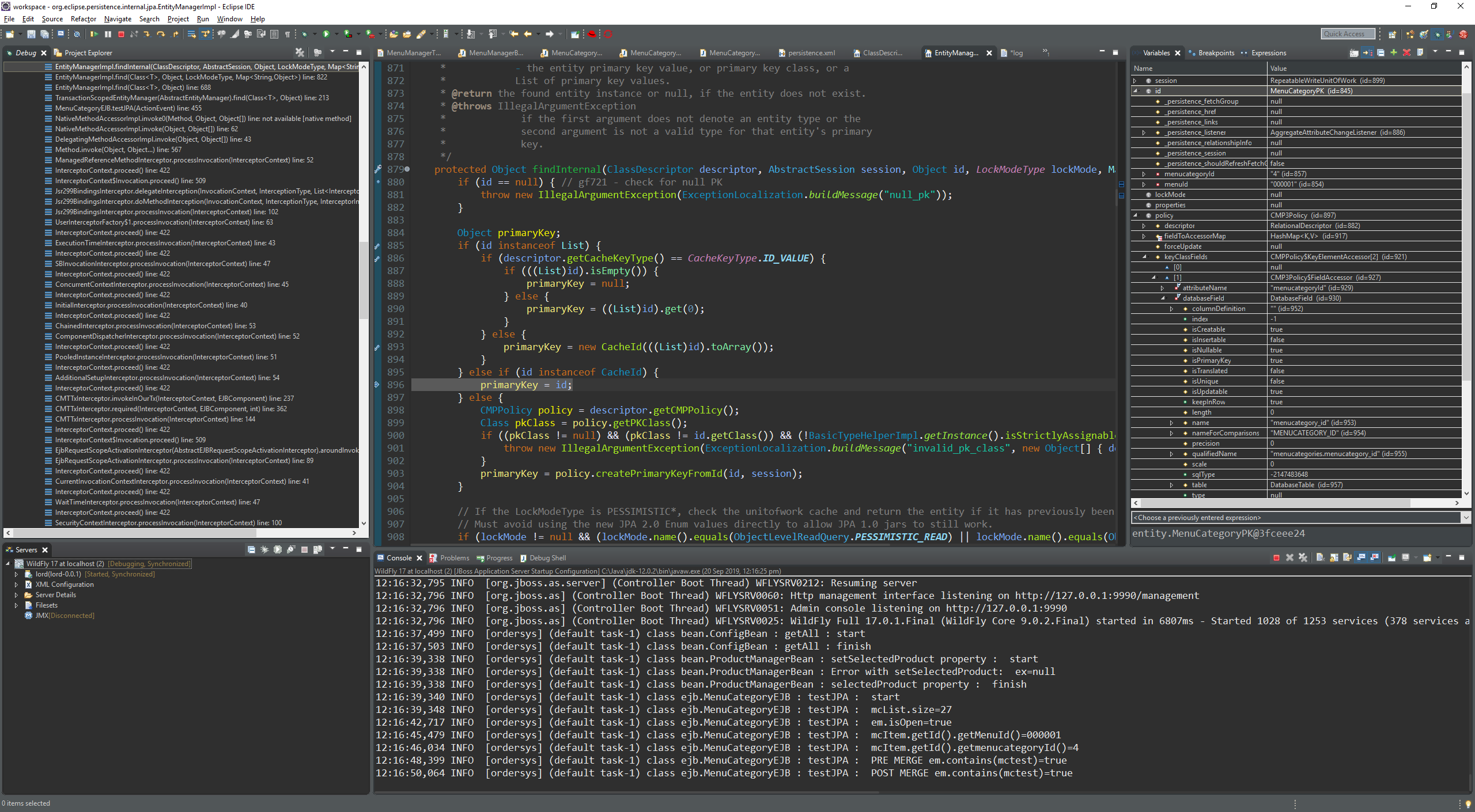

Hi Folks,
I'm new to JPA and Eclipselink (2.7).
I'm getting null exception when using em.find, even when em.contains returns true.
I use a composite key @Embeddable class MenuCategoryPK for entity MenuCategory.
It seems to be a problem in CMP3Policy.createPrimaryKeyFromId - see attached screen shot.
Here the test code.

this is the run result
11:54:29,830 INFO [ordersys] (default task-1) class ejb.MenuCategoryEJB : testJPA : start
11:54:29,836 INFO [ordersys] (default task-1) class ejb.MenuCategoryEJB : testJPA : mcList.size=27
11:54:32,315 INFO [ordersys] (default task-1) class ejb.MenuCategoryEJB : testJPA : em.isOpen=true
11:54:34,020 INFO [ordersys] (default task-1) class ejb.MenuCategoryEJB : testJPA : mcItem.getId().getMenuId()=000001
11:54:34,020 INFO [ordersys] (default task-1) class ejb.MenuCategoryEJB : testJPA : mcItem.getId().getmenucategoryId()=4
11:54:34,020 INFO [ordersys] (default task-1) class ejb.MenuCategoryEJB : testJPA : PRE MERGE em.contains(mctest)=true
11:54:34,020 INFO [ordersys] (default task-1) class ejb.MenuCategoryEJB : testJPA : POST MERGE em.contains(mctest)=true
11:56:24,149 INFO [ordersys] (default task-1) class ejb.MenuCategoryEJB : testJPA : ex=null
11:56:24,149 INFO [ordersys] (default task-1) class ejb.MenuCategoryEJB : testJPA : finish
Stack dump

NotificationReceiverHandler.handleRequest(HttpServerExchange) line: 50
SecurityInitialHandler(AbstractSecurityContextAssociationHandler).handleRequest(HttpServerExchange) line: 43
PredicateHandler.handleRequest(HttpServerExchange) line: 43
JACCContextIdHandler.handleRequest(HttpServerExchange) line: 61
GlobalRequestControllerHandler.handleRequest(HttpServerExchange) line: 68
ServletInitialHandler.handleFirstRequest(HttpServerExchange, ServletRequestContext) line: 292
ServletInitialHandler.access$100(ServletInitialHandler, HttpServerExchange, ServletRequestContext) line: 81
ServletInitialHandler$2.call(HttpServerExchange, ServletRequestContext) line: 138
ServletInitialHandler$2.call(HttpServerExchange, Object) line: 135
ServletRequestContextThreadSetupAction$1.call(HttpServerExchange, C) line: 48
ContextClassLoaderSetupAction$1.call(HttpServerExchange, C) line: 43
SecurityContextThreadSetupAction.lambda$create$0(ThreadSetupHandler$Action, HttpServerExchange, Object) line: 105
980673153.call(HttpServerExchange, Object) line: not available
UndertowDeploymentInfoService$UndertowThreadSetupAction.lambda$create$0(ThreadSetupHandler$Action, HttpServerExchange, Object) line: 1502
820757914.call(HttpServerExchange, Object) line: not available
ServletInitialHandler.dispatchRequest(HttpServerExchange, ServletRequestContext, ServletChain, DispatcherType) line: 272
ServletInitialHandler.access$000(ServletInitialHandler, HttpServerExchange, ServletRequestContext, ServletChain, DispatcherType) line: 81
ServletInitialHandler$1.handleRequest(HttpServerExchange) line: 104
Connectors.executeRootHandler(HttpHandler, HttpServerExchange) line: 364
HttpServerExchange$1.run() line: 830
ContextClassLoaderSavingRunnable.run() line: 35
EnhancedQueueExecutor.safeRun(Runnable) line: 1982
EnhancedQueueExecutor$ThreadBody.doRunTask(Runnable) line: 1486
EnhancedQueueExecutor$ThreadBody.run() line: 1377
Thread.run() line: 835
