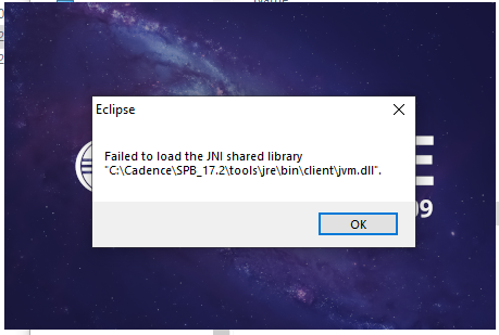

I'm a new user of the platform, and I already installed Java but can't run the eclipse app to use it as my environment, and I think is conflicting with other programs I have installed since it shows me this weird error everytime I try to run it (see attached).
Any comment will be helpful.

Did you create the installation using the installer?
On Windows, the installer is a native executable that looks in your system registry for Java installations and likely does a better job of finding a suitable one so that it does the following manual steps automatically:
https://wiki.eclipse.org/Eclipse.ini
