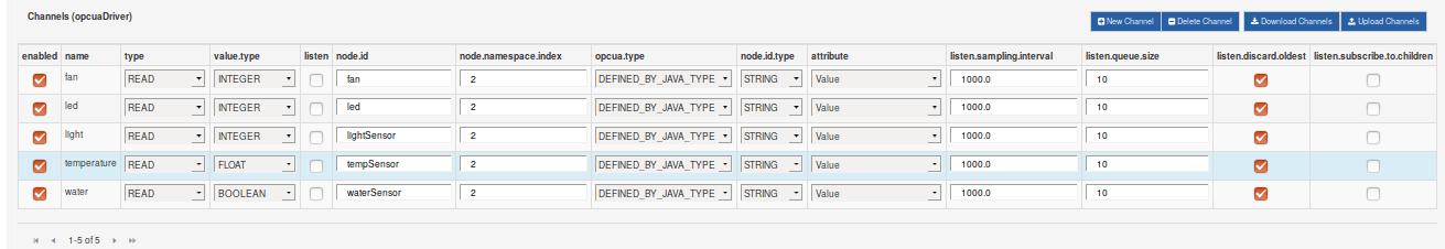

The channels of the OPC UA asset are shown in attached image kura1.png.

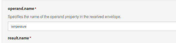

The operand.name field is shown in attached file kura2.png.
Is it possible that I didn't defined other fields of the channel properly?

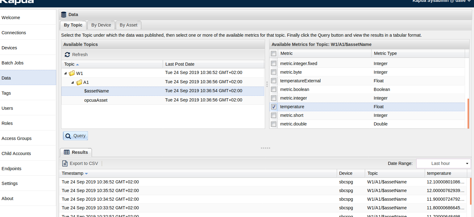

we're using an OPC UA simulated device. We're pretty sure it works properly because temperature data is sent to the cloud:
index.php/fa/36380/0/
However, we can't see any logging messages related to this field:

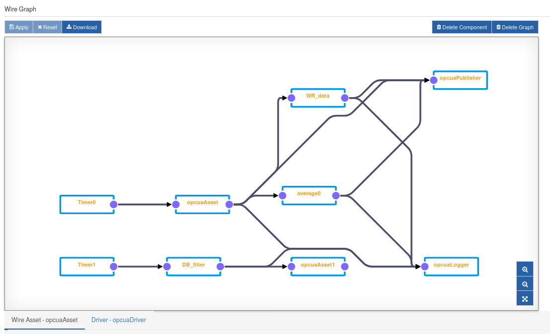

The entire application looks like this:
index.php/fa/36382/0/
