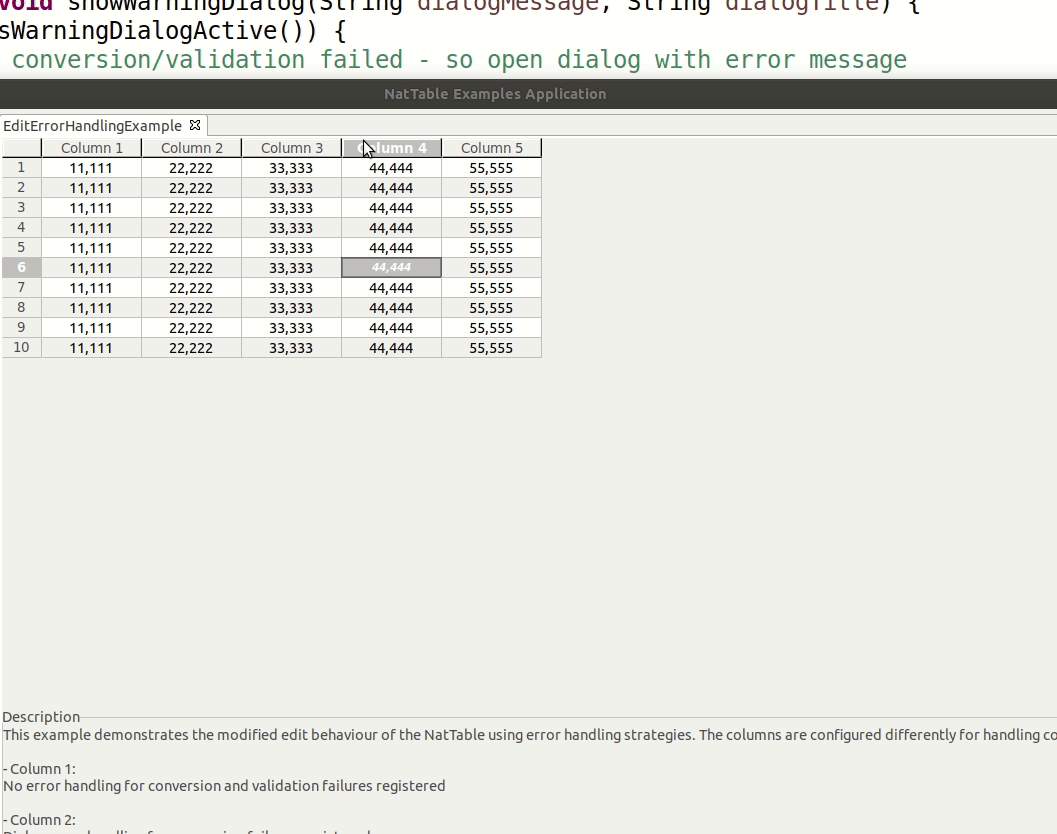

In nattable examples "EditErrorHandlingExample" column4 provides a dialog for handling error messages. But if i click outside the dialog area and click back on the dialog , it popup another dialog. Please see the gif in the attachment, does anyone has a solution for the same?

Actually on Windows this does not happen. The MessageDialog opens modal, so you can't change the focus which would lead to that situation. I suppose an issue on GTK SWT.
You could try to locally override DialogErrorHandling#showWarningDialog() and add
warningDialog.setBlockOnOpen(true);
This should be true by default, but maybe it is not on Linux. If that works it would be great if you could provide feedback and even a Gerrit patch so we can fix it this way. Otherwise a SWT GTK bug needs to be created.
