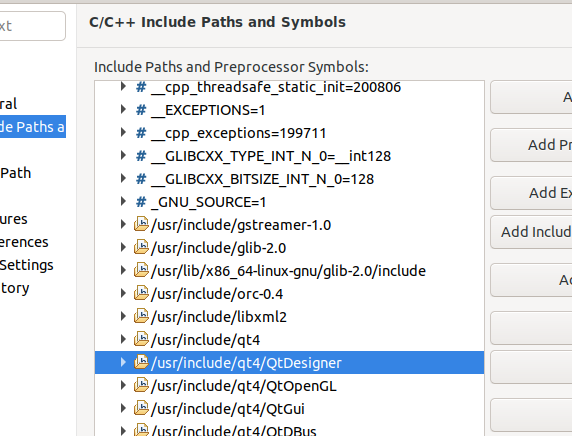

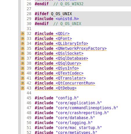

I'm trying to get a cmake C/C++ project into Eclipse and generated the project specifics as follows
cmake -G "Eclipse CDT4 - Unix Makefiles" -DCMAKE_BUILD_TYPE=Debug -DCMAKE_ECLIPSE_GENERATE_SOURCE_PROJECT=TRUE -DCMAKE_ECLIPSE_MAKE_ARGUMENTS=-j3 -DCMAKE_ECLIPSE_VERSION=4.12   work/myclemetine
The resulting .cproject file contains all required Symbols and include paths (see attached Paths.png), but I get unresolved inclusion errors (see attached Code.png)
I'm sure it's something trivial I'm missing, but can't work out what.

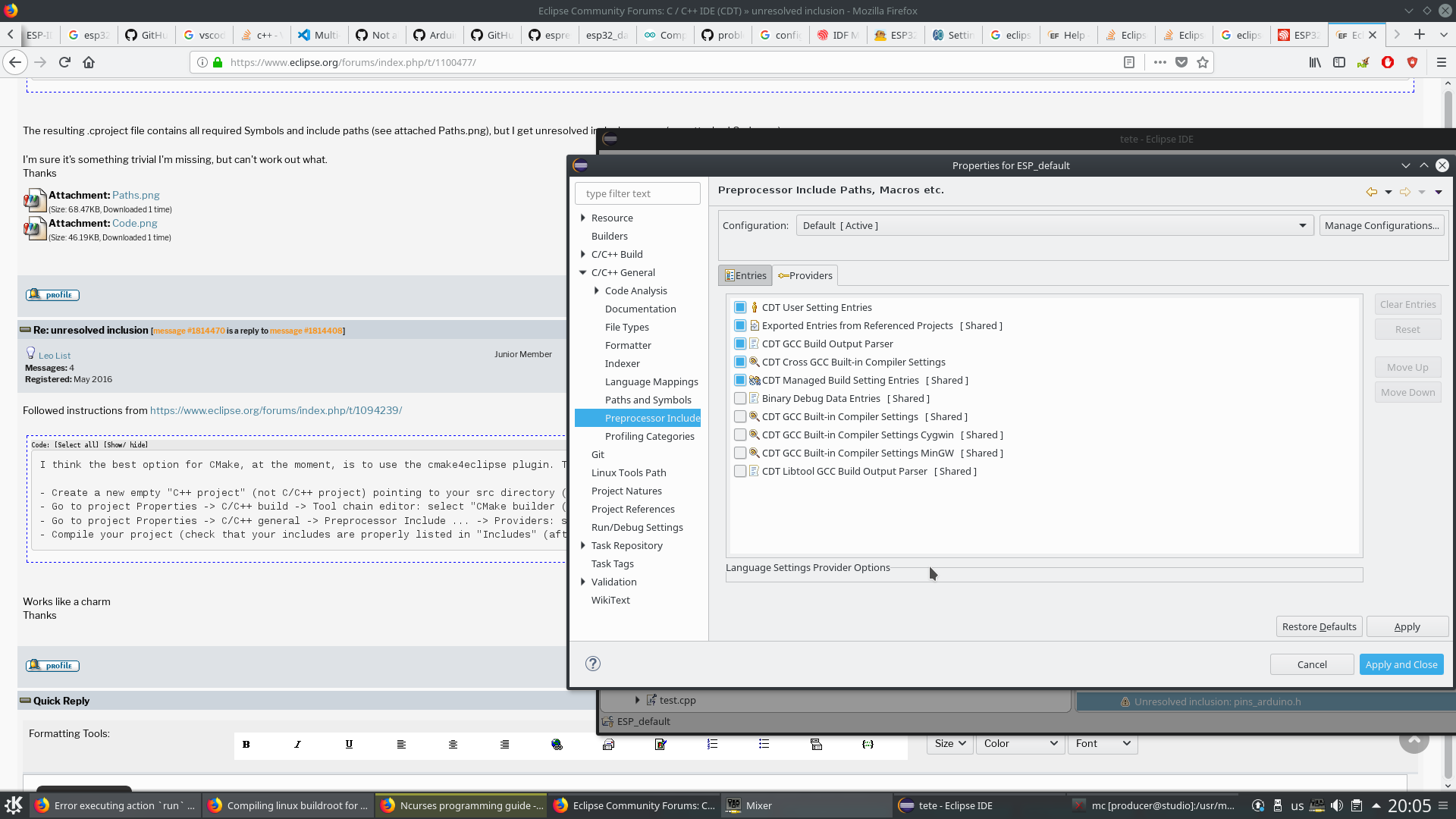

Followed instructions from https://www.eclipse.org/forums/index.php/t/1094239/
I think the best option for CMake, at the moment, is to use the cmake4eclipse plugin. The built-in CMake support is currently not at the level of this plugin.
- Create a new empty "C++ project" (not C/C++ project) pointing to your src directory (with the root CMakeLists.txt).
- Go to project Properties -> C/C++ build -> Tool chain editor: select "CMake builder (portable)" as current builder.
- Go to project Properties -> C/C++ general -> Preprocessor Include ... -> Providers: select "CMAKE_COMPILE_COMMANDS_JSON Parser" and "CMAKE_COMPILE_COMMANDS_JSON Compiler Built-Ins".
- Compile your project (check that your includes are properly listed in "Includes" (after the successful build).
Works like a charm

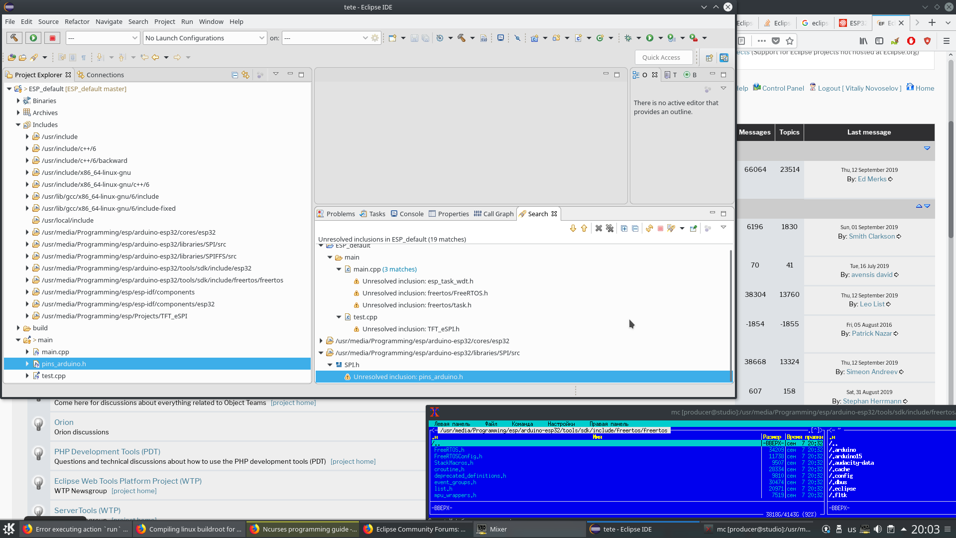

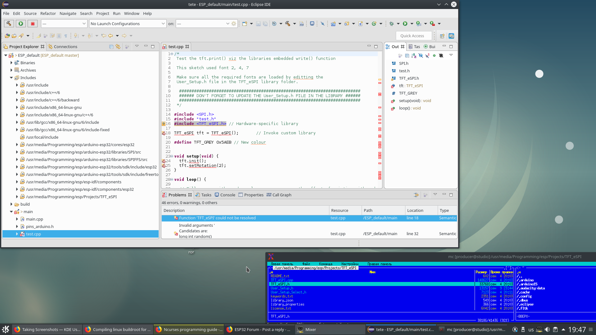

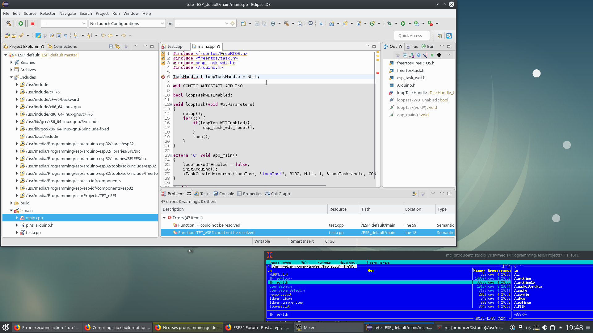

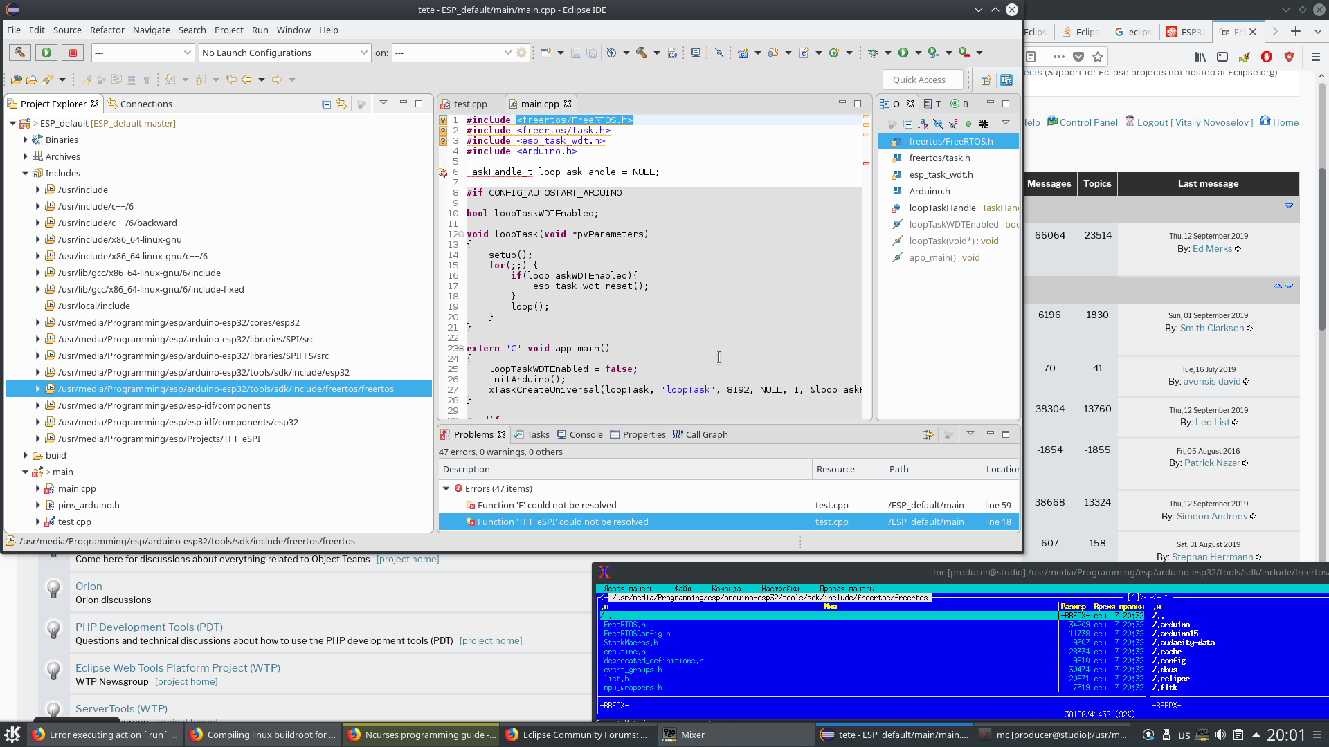

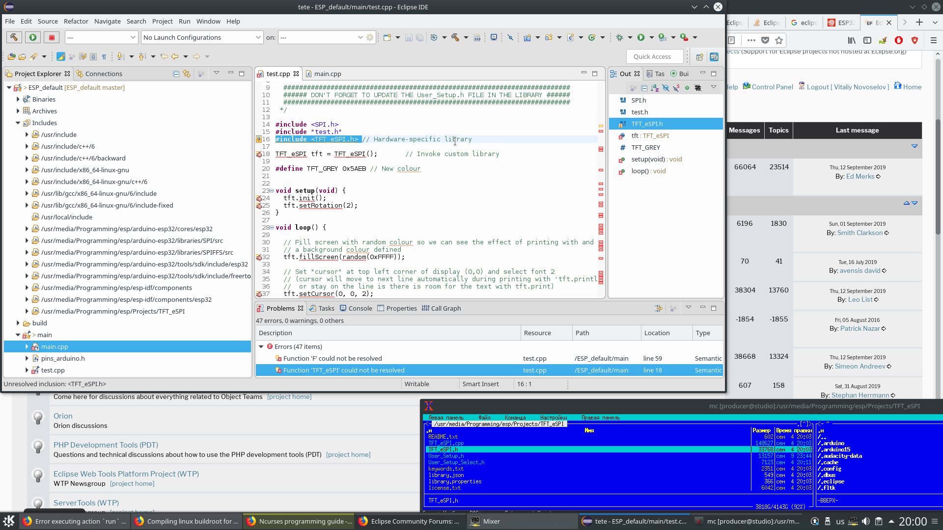

Hi have a lil another troubles. Starting to work with ESP32. installed ESP-IDF, untarred arduino-esp32 for modules, configured as esp32 manuals sad (Gross GCC compiller). but in any case Eclipse won't to see include files.
How to configure project to see another projects' sources?
Re: unresolved inclusion [message #1814527 is a reply to message #1814470] Thu, 12 September 2019 13:12 Go to previous message
and another 2 screensots
