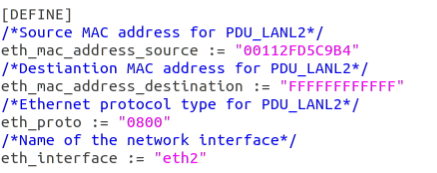

Dynamic test case error: LANL2asp_PT('LANL2_PCO'): Cannot open socket on interface 'ens33' for reading with pcap. (Operation not permitted)
it was error with eth2 before,
index.php/fa/36194/0/
I thought there is a ens33 on my wireshark, so I changed it, still not working.
So, as topic said, if any one knows how to get available network interface name, that would be really amazing.

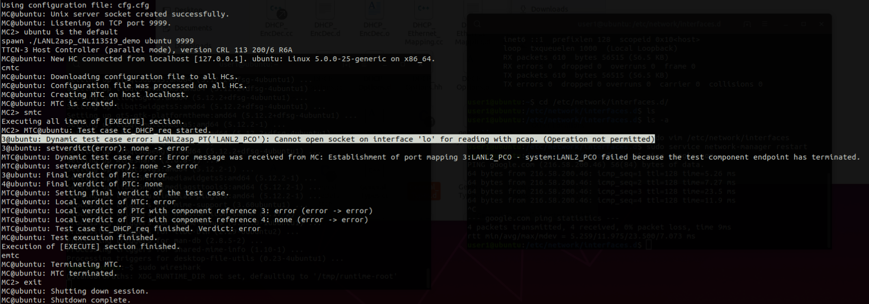

---update1---
I surfed on internet for a while and I found that I could look up to /etc/network/interface,
and I found my interface name is "lo".

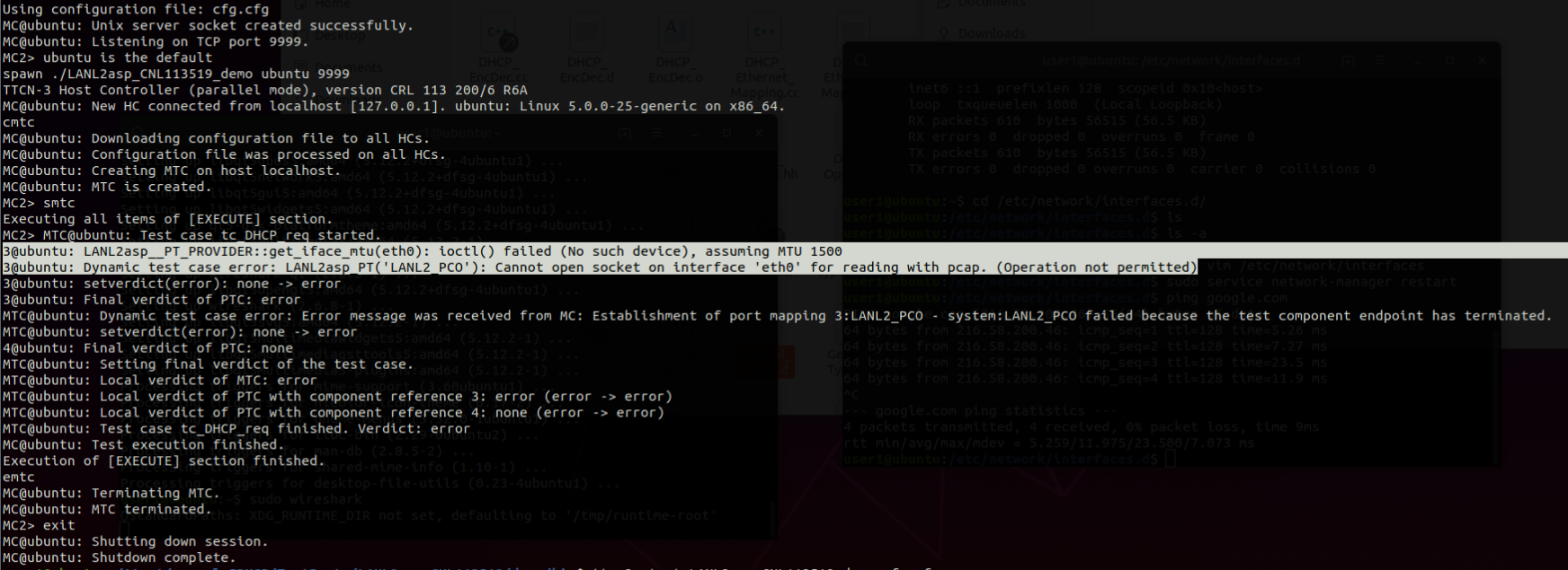

after I change to lo, one error is fixed:
3@ubuntu: LANL2asp__PT_PROVIDER::get_iface_mtu(eth0): ioctl() failed (No such device), assuming MTU 1500
index.php/fa/36196/0/
It was like below before:
index.php/fa/36195/0/
However, the dynamic error still exist :(
Dynamic test case error: LANL2asp_PT('LANL2_PCO'): Cannot open socket on interface 'lo' for reading with pcap. (Operation not permitted)
Any ideas is welcome guys.

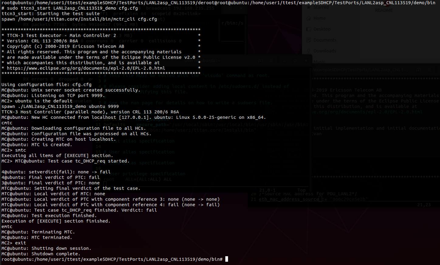

Re: How to know what network interface I'm using is? [message #1811306 is a reply to message #1811305] Fri, 30 August 2019 08:03 Go to previous messageGo to next message
Hi everyone,

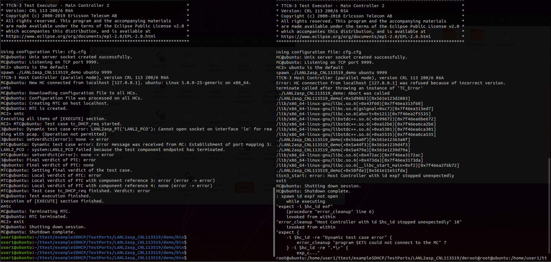

I did tried to run as root(sudo ttcn3_start LANL2asp_CNL113519 cfg.cfg), but things got weird like this
Error: HC connection from localhost [127.0.0.1] was refused because of incorrect version.
so I thought it was wrong...
index.php/fa/36197/0/
Terminal on the right is the result that I run terminal as root, as same as the sudo one.
Do you guys have any clue about this situation..?
Best regards
Sean
Re: How to know what network interface I'm using is? [message #1811307 is a reply to message #1811306] Fri, 30 August 2019 08:13 Go to previous messageGo to next message
You have a TITAN version mismatch. MC is R5A while the HC is R6A.
Make sure to use same TITAN version for MC and HC!

The MC was R6A (on the left) when I executed in unprivileged account,
why it become R5A when I did it in root?
I was installed titan direct from git hub, why would the version become different?
Thanks for your time ans patience again.
Best regards
Sean
Re: How to know what network interface I'm using is? [message #1811327 is a reply to message #1811314] Fri, 30 August 2019 23:01 Go to previous messageGo to next message
Hi Sean,
When you are switching accounts, the environment variables can and usually will change.
If you don't need the R5 installation, delete it to avoid confusion, and then make sure to check the
environment variables as specified during installation for both shells.
Now from the use shell R6 is visible,while from the root , R5.
Be aware that Ubuntu/Debian may already contain a default Titan install,
That is probably the origin of R5.
You can remove it with apt remove xxxx
BR
Elemer

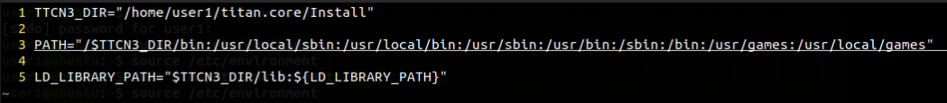

Re: How to know what network interface I'm using is? [message #1814027 is a reply to message #1811327] Mon, 02 September 2019 01:34 Go to previous messageGo to next message
Hi Elemer,
So sorry to bother you with such a trivial problem, I have already removed eclipse-titan, even reinstall titan.core from github, but no matter how I edit /etc/environment and source it, ttcn3_start still only work in user mode but root mode, "sudo: ttcn3_start: command not found".
Could you please give me a hint about how to fix this titan installation problem?
This is how my /etc/environment looks like right now.
index.php/fa/36201/0/
---update---
This is so relieving when I found out I should delete env reset in /etc/sudoers and add $ttcn3_dir/bin into secure_path, finally can work with sudo!

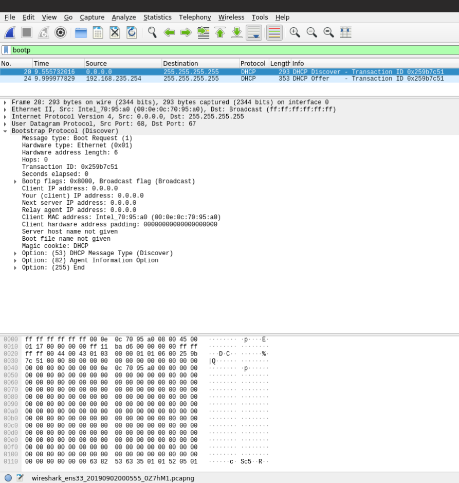

---update2---

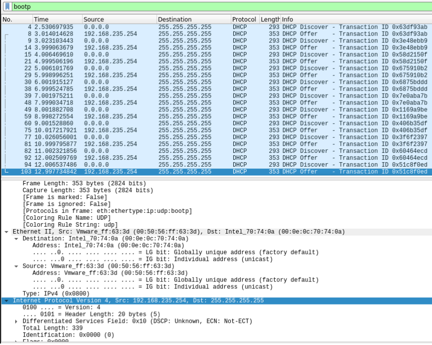

It doesn't need to reconnect, and I can get two bootp on wireshark.
index.php/fa/36203/0/
Just don't quite understand why discover would fail, currently grinding this part.

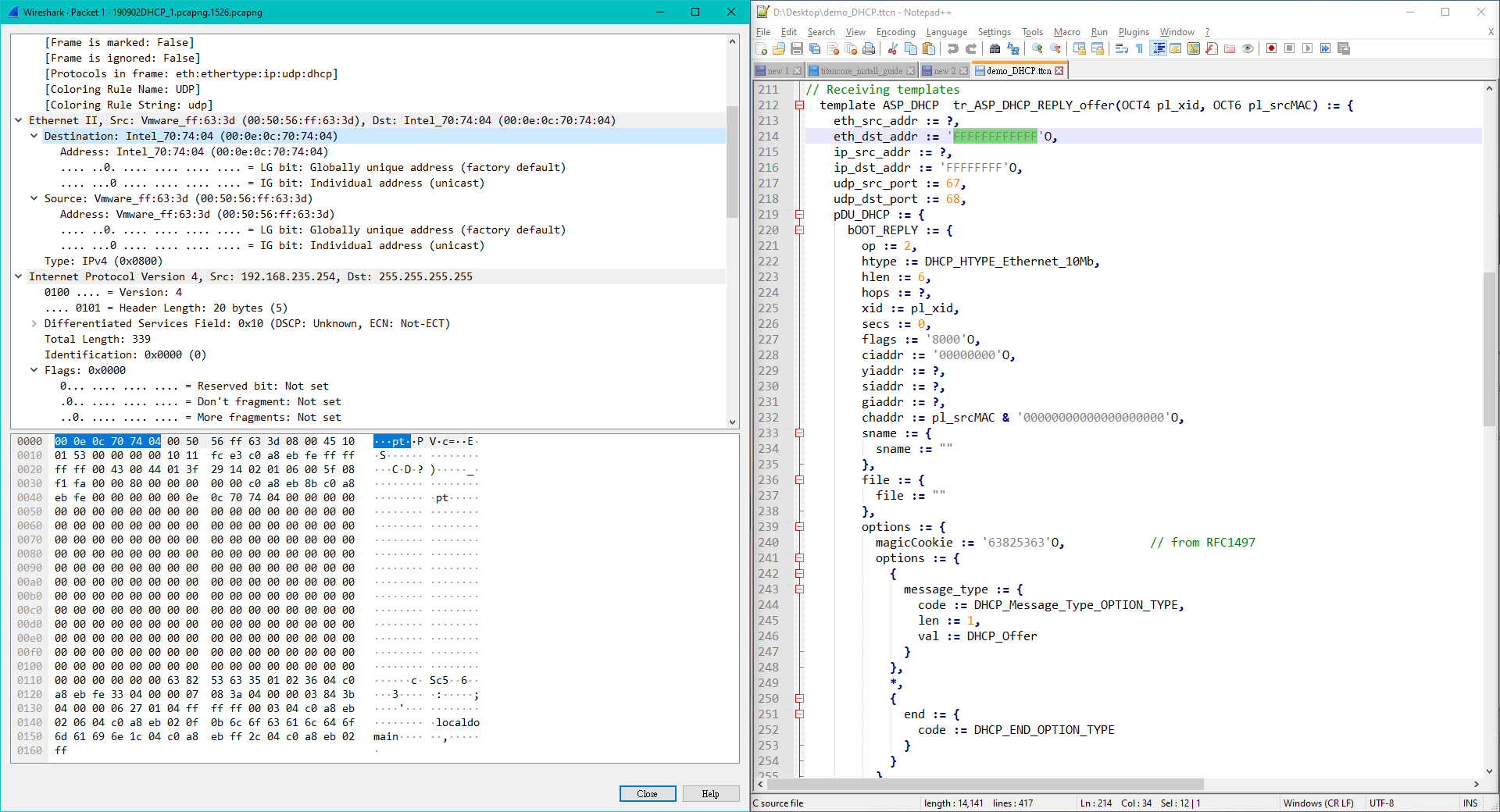

Keep trying to edit demo_DHCP.ttcn to get a different result,
and found a problem that make twice would encounter a pcapclose not able to reference problem.
I don't have much time to dig in to what this is (but any ideas is still welcome) so I came up with a brainless way to avoid it: open another terminal and make in that terminal, voila.
---update6---
If there is anyone interested, the 190902DHCP_1.pcapng.1526.pcapng in file attachment is the DHCP offer packet I received, and the offer template in ttcnfile looks like below:
  template ASP_DHCP  tr_ASP_DHCP_REPLY_offer(OCT4 pl_xid, OCT6 pl_srcMAC) := {
    eth_src_addr := ?,
    eth_dst_addr := 'FFFFFFFFFFFF'O,
    ip_src_addr := ?,
    ip_dst_addr := 'FFFFFFFF'O,
    udp_src_port := 67,
    udp_dst_port := 68,
    pDU_DHCP := {
      bOOT_REPLY := {
        op := 2,
        htype := DHCP_HTYPE_Ethernet_10Mb,
        hlen := 6,
        hops := ?,
        xid := pl_xid,
        secs := 0,
        flags := '8000'O,
        ciaddr := '00000000'O,
        yiaddr := ?,
        siaddr := ?,
        giaddr := ?,
        chaddr := pl_srcMAC & '00000000000000000000'O,
        sname := {
          sname := ""
        file := {
          file := ""
        options := {
          magicCookie := '63825363'O,            // from RFC1497
          options := {
              message_type := {
                code := DHCP_Message_Type_OPTION_TYPE,
                len := 1,
                val := DHCP_Offer
              end := {
                code := DHCP_END_OPTION_TYPE
        }//options end
      }//boot_reply end
    }//PDU DHCP end
  }//ASP DHCP end
Question about how to make the DHCP offer accepted is still open guys :)
Best regards
Sean

Re: How to know what network interface I'm using is? [message #1814066 is a reply to message #1814027] Mon, 02 September 2019 13:45 Go to previous messageGo to next message
Hi Sean,
Your questions should be answered by a careful analysis of the logs generated by Titan.
The most likely cause for rejection of the DHCP message is a mismatch between the message itself
And the receiving template. Please compare them field by field.
By the way you have made quite a progress.
BR
Elemer

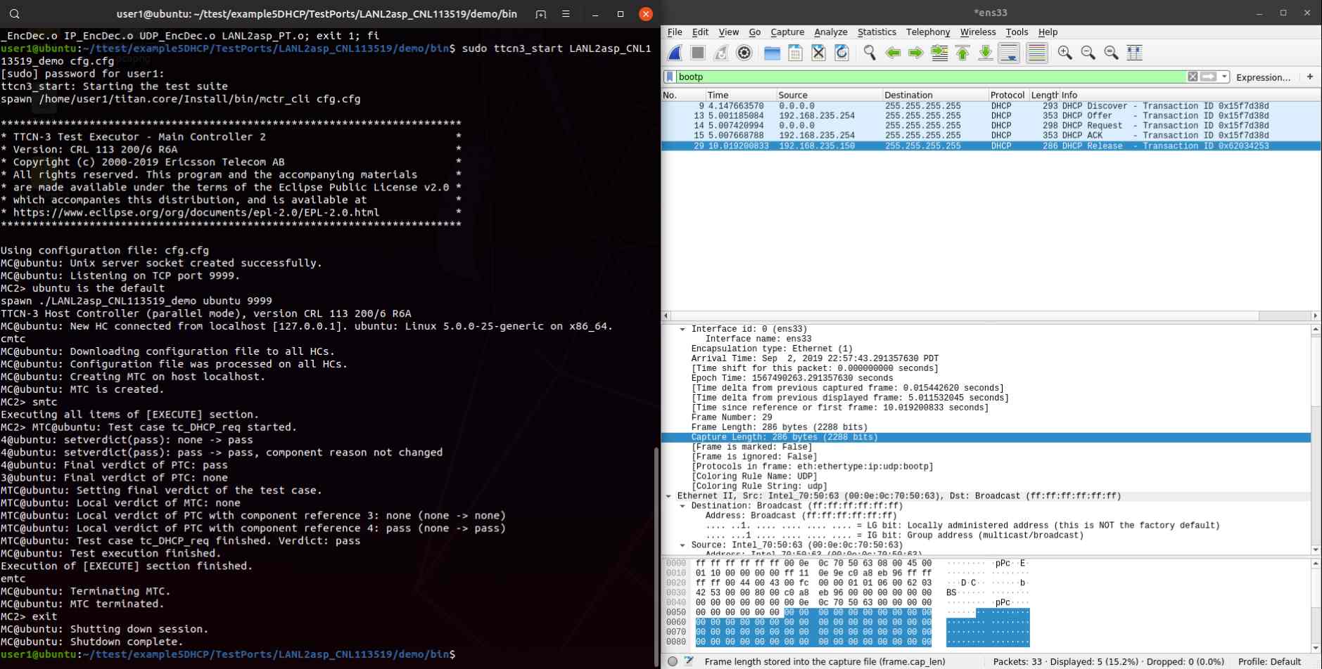

Re: How to know what network interface I'm using is? [message #1814074 is a reply to message #1814066] Tue, 03 September 2019 02:30 Go to previous messageGo to next message
Hi Elemer,
You are right sir.
Turns out it was the eth dst set in the tr_ASP_DHCP_REPLY_offer template made the fail call.
index.php/fa/36210/0/
I changed the dst to \?, then the mtc accept the offer happily.
Now, the offer is accept, however, it still gave me a fail verdict again and stop at ack.
index.php/fa/36211/0/
So I make the same trick I made in offer again in ack.
Now I got a really nicely pass.
index.php/fa/36212/0/
All of this must credit to you, all project developer, and ttcn course you posted, thanks you again!
