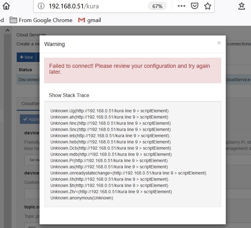

I am trying to connect using KURA 3.20 on a Raspberry Pi, to AWS IoT. To try and help you, I attached a screenshot of the error message, but it is;
Failed to connect! Please review your configuration and try again later.
Show Stack Trace
Unknown.Ug<IP Address of my Device>/kura line 9 > scriptElement)
Unknown.ah<IP Address of my Device>/kura line 9 > scriptElement)
etc
Any help would be appreciated.
Mike

Re: Problem using KURA Client to connect to AWS IoT [message #1810916 is a reply to message #1810837] Wed, 21 August 2019 23:36 Go to previous message
I have used this Raspberry Pi with KURA to connect previously to my Eurotech Sanbox account. But I just cannot get it to connect to AWS. As you suggested I have checked the logs.
Note. I have already, very carefully followed these instructions.. thanks .. http://eclipse.github.io/kura/cloud-stacks/kura-aws-cloud.html I am using KURA 3.2, and everything is set-up. I had no errors.
In terms of the logs;
The KURA log has nothing in it, since I last connected to Eurotech. I have deleted my "Eurotech" config details. So, I am now only using One Connection to AWS, as per the above instructions. The kura-console.log has recent log details, as below. I have included a few connection attempts from the past few days. Can you see what's wrong?
