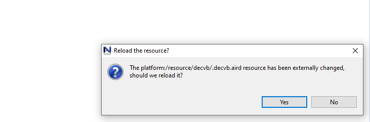

Iam getting the below exception while opening the representation how to avoid it
.aird resource has been externally changed,should we reload it exception
Any suggestions to solve the below issue.Attaching the screenshot
Re: How to avoid .aird resource has been externally changed,should we reload it exception? [message #1810621 is a reply to message #1810393] Wed, 14 August 2019 09:08 Go to previous message
This message occurs when modification are done outside of the resource set handled by the Sirius session. That means someone that is not Sirius is doing external changes outside of the Sirius resource set while the representation is opened.
The solution is to find who is doing these external changes while loading a representation.
