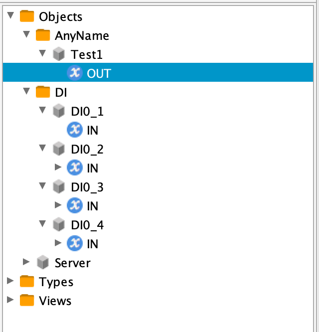

There server is configured as per attached 1.png:
index.php/fa/36065/0/
It is configured on a docker host and exposes the OPC-UA server as expected
index.php/fa/36066/0/

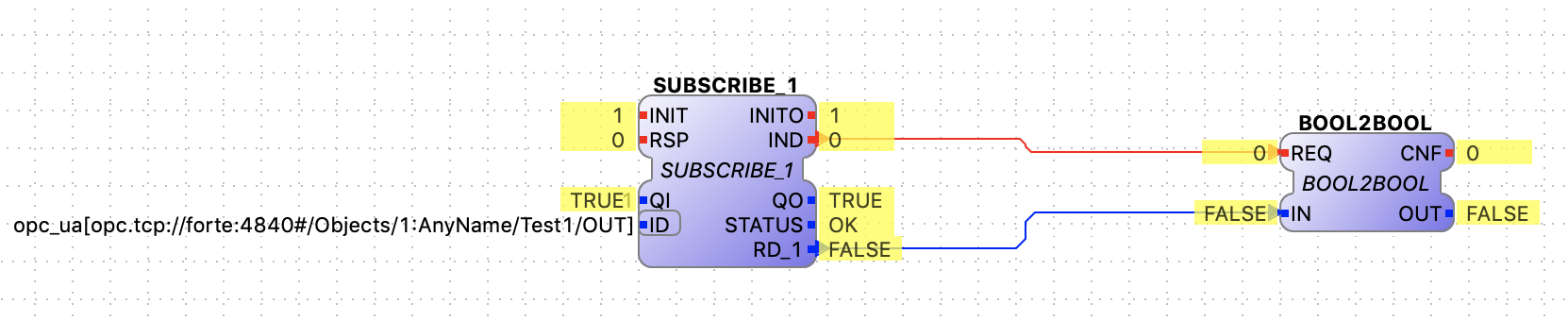

index.php/fa/36067/0/
Both the Forte RTE are running on the same docker host therefore allowing connection using the container name opc.tcp://forte:4840, which is the name of the server.
When deployed the client we get the following error message in the client logs:
Adding monitoring variable
failed: BadSubscriptionIdInvalid
we see that the connection is establish, but the client fails to subscribe to the OPC-UA server point.
Do you have any suggestion as to why this is happening?

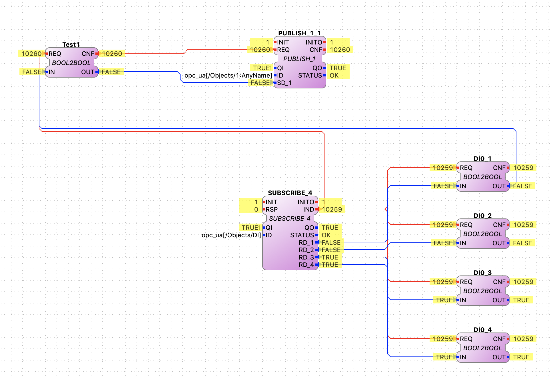

We've managed to compile the feature branch, but It looks like the OPC_UA format has changed in the way they are specified in the 4DIAC function blocks., now getting:
ERROR: T#2444009991828: [OPC UA ACTION]: Parameters /Objects/1:AnyName should have at least 2 parts, separated by a semicolon
ERROR: T#2444010586993: [OPC UA ACTION]: Parameters /Objects/DI should have at least 2 parts, separated by a semicolon
What is the correct format to specify in the publish and subscribe function blocks?
Re: OPC UA connection issue [message #1810582 is a reply to message #1810578] Tue, 13 August 2019 12:36 Go to previous messageGo to next message
oh yeah, it changed.. you can find a small readme under org.eclipse.4diac.forte\src\modules\opc_ua\readme.md

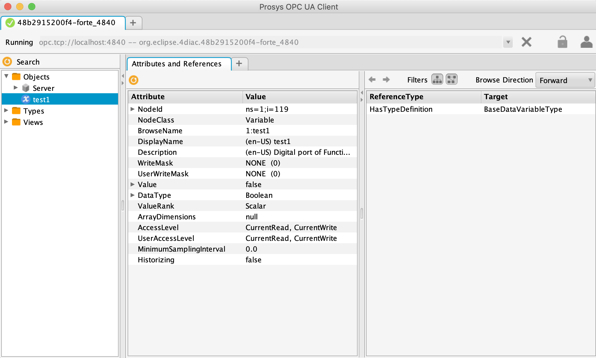

However, the remote WRITE is giving us some issues. From reading the README file in the OPC_UA source folder it looks like the below connection should work.
The server has created the below data object as shown, which when changed from the Prosys ops ua client does change in 4DIAC when monitoring the function blocks
index.php/fa/36113/0/

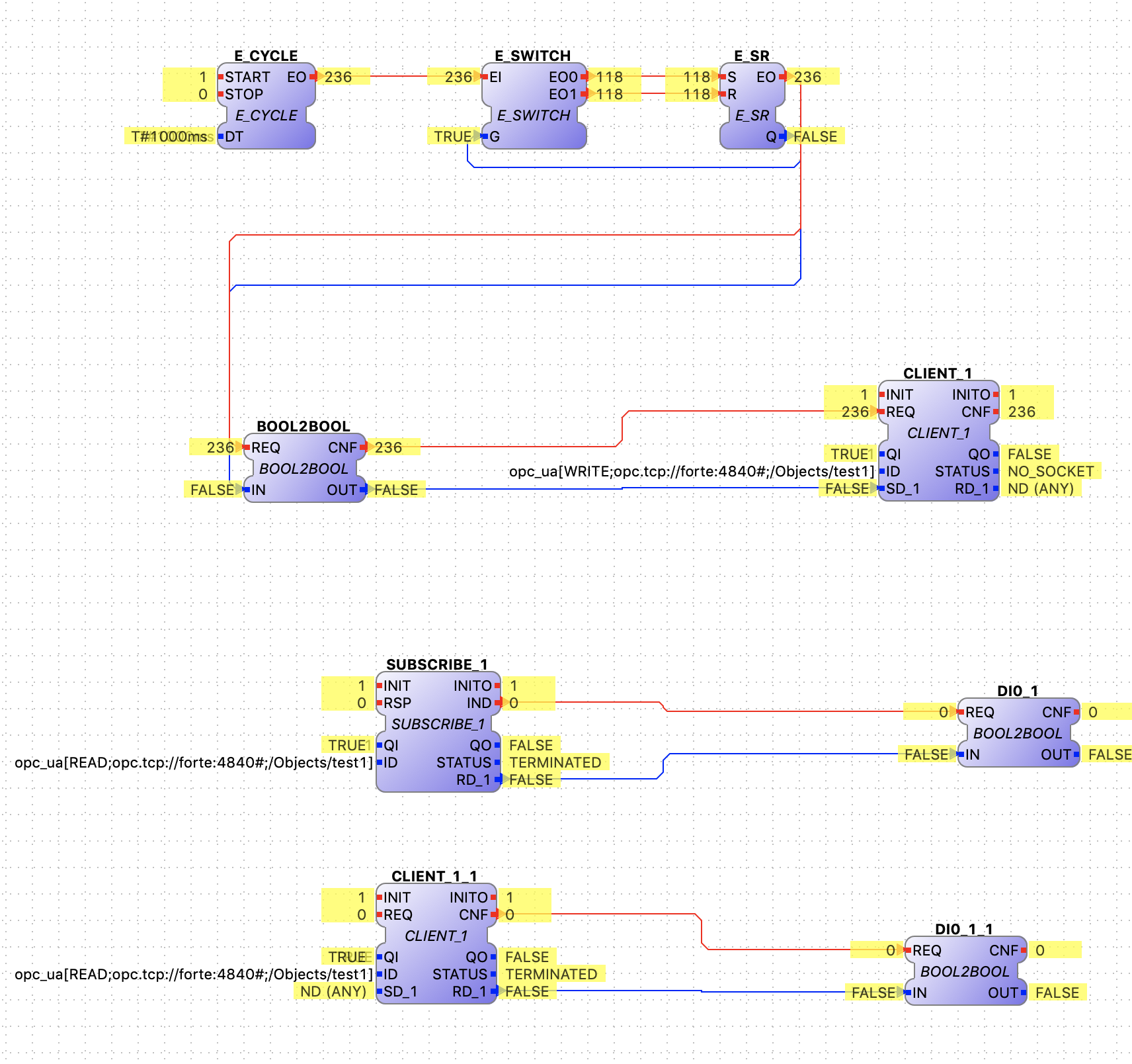

When deploying from the forte client to try and read and write from in Remote mode as per the Logic below, we get 3 errors, which doesn't appear to match the instruction in the README file:
INFO: T#38516097655094: FORTE is up and running
INFO: T#38516097700594: Using provided bootfile location set in CMake: forte.fboot
INFO: T#38516097733894: Boot file forte.fboot could not be opened. Skipping...
INFO: T#38516097746694: CBSDSocketInterface: Opening TCP-Server connection at: localhost:61499
INFO: T#38541697911994: Connection established by client
ERROR: T#38541728933294: [OPC UA LAYER]: Connection RD_1 of FB CLIENT_1 is not connected to anything.
ERROR: T#38541729030994: [OPC UA ACTION]: Remote SUBSCRIBE_1 action is only allowed using a Client FB, the amount of BrowseName,NodeId pairs should match the number of RDs, and must have no SDs
ERROR: T#38541729287794: [OPC UA LAYER]: Got invalid port connection on FB CLIENT_1_1 at port SD_1. It must be connected to another FB.
INFO: T#38541729759494: Connection closed by peer
INFO: T#38541781822994: Connection established by client
index.php/fa/36115/0/
Do you have any suggestion as to how to get the Remote READ / WRITE working based on the above?
Re: OPC UA connection issue [message #1810666 is a reply to message #1810663] Thu, 15 August 2019 10:45 Go to previous messageGo to next message
Hi Mariusz ,
It says, in your CLIENT_1 FB the RD_1 port should be connected to a suitable convert FB, so that forte knows the data type of the output data. However, as you just using it for writing a data value, you need CLIENT1_0 FB instead (with no SD_x ports)
All remote operations use the Client FB for now. If you read a value, you need the CLIENT0_1 FB (no RDs, one SD port)
same. use CLIENT0_1 FB instead
Hope this helps.
Re: OPC UA connection issue [message #1810668 is a reply to message #1810666] Thu, 15 August 2019 12:12 Go to previous messageGo to next message
We are using 4DIAC 1.10 and i cannot see the function block you are mentioning, how do we include that to the library or what version should we be using?
Re: OPC UA connection issue [message #1810674 is a reply to message #1810668] Thu, 15 August 2019 14:24 Go to previous messageGo to next message
These FBs are generic in 4diac FORTE. Therefore you can simple take one of the suiting FBs e.g., CLIENT_2_1, copy it, give it the right name (i.e., CLINET_1_0, and adjust the interface to your needs. You don't need to generate any Cpp code or do anything else. 4diac FORTE will based on the type name create the correct FB during FB instantiation.

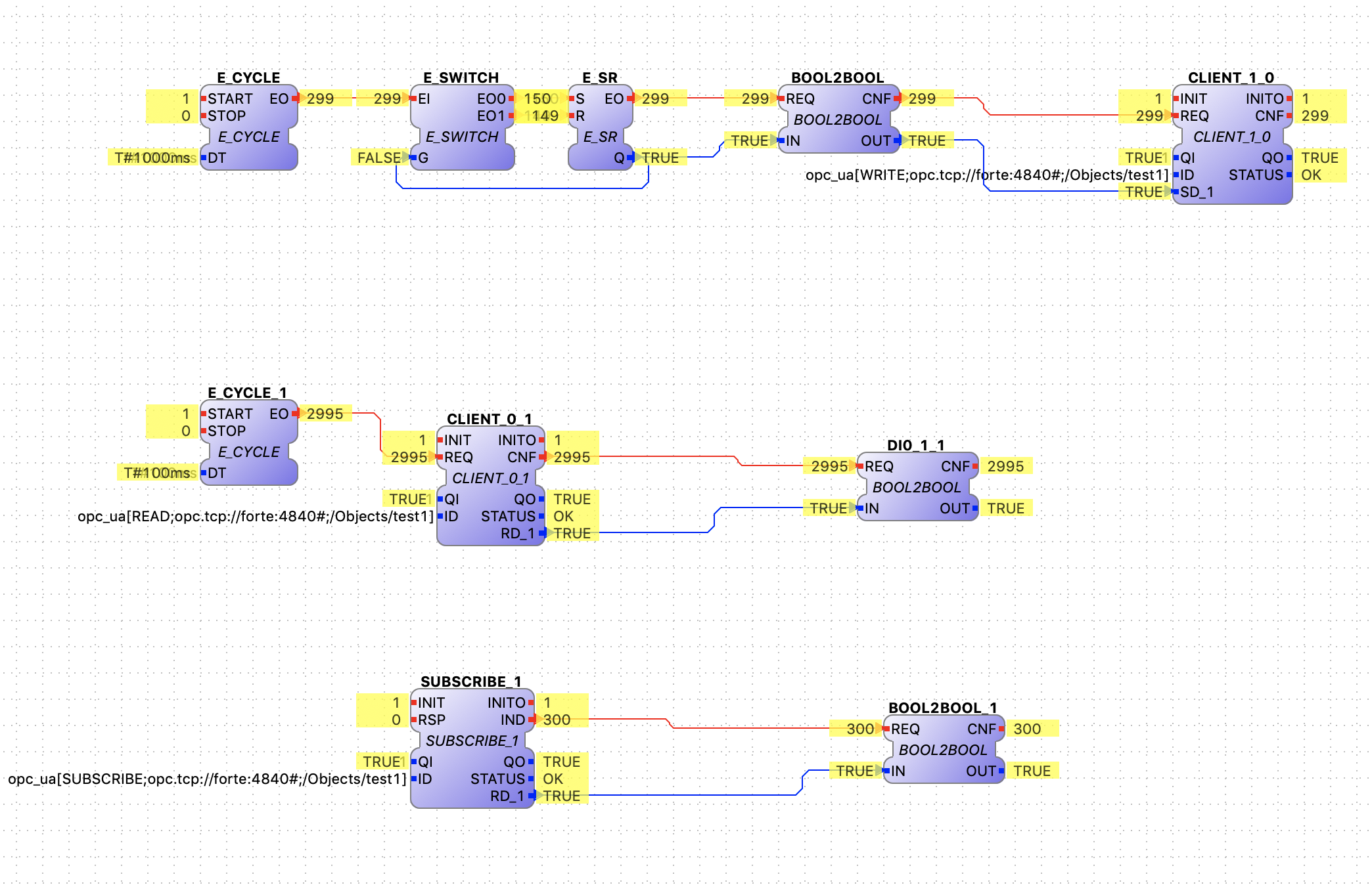

Here is the working setup with both READ, WRITE and SUBSCRIBE from the remote client.
index.php/fa/36118/0/
