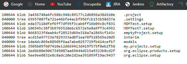

The attached screenshot is format of bitbucket server directory (setups) raw response .

The main problem was that the raw format of directory from bitbucket could not be parsed by oomph (format in attached image).
