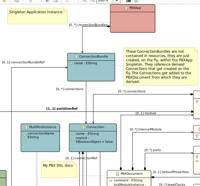

index.php/fa/36079/0/
Hopefully this picture helps.
My derived Connections are able to be added to the PBXDocuments - the documents for my DSL.
But I need to create an overall association of these derived Connections, which I call ConnectionBundles. There is no place in the DSL where these ConnectionBundles are described, so they are, indeed, not contained within an resource.
I have a DSL file that can make references to these ConnectionBundles - and thus I am referencing an Object that has easy access to all the associated Connections.

I can scope and validate that ConnectionBundle reference, but I can't get past the dangling reference error. When I'm scoping the ConnectionBundle and Connection references in this highly cross referenced file, I simply access my pbxApp.getInstance() singleton which contains a list of derived ConnectionBundles.
I have a file that is predominantly built with crossReferences to ConnectionBundles (and the associated derived Connections). What I'm finding is when I load my application and that file is loaded, ALL references are marked as errors - all derived ConnectionBundles and Connections. The Connections are derived and contained within Resources, so I don't understand why their derivations aren't being triggered. I'm having to Project -> Clean to get any of those objects built and linked.
I can understand why the ConnectionBundles are not created, but the cross references to Connections, that are derived and contained within resources, I don't understand why the builder isn't triggering a build and creating them. Is it because there's major cross reference error before them?
