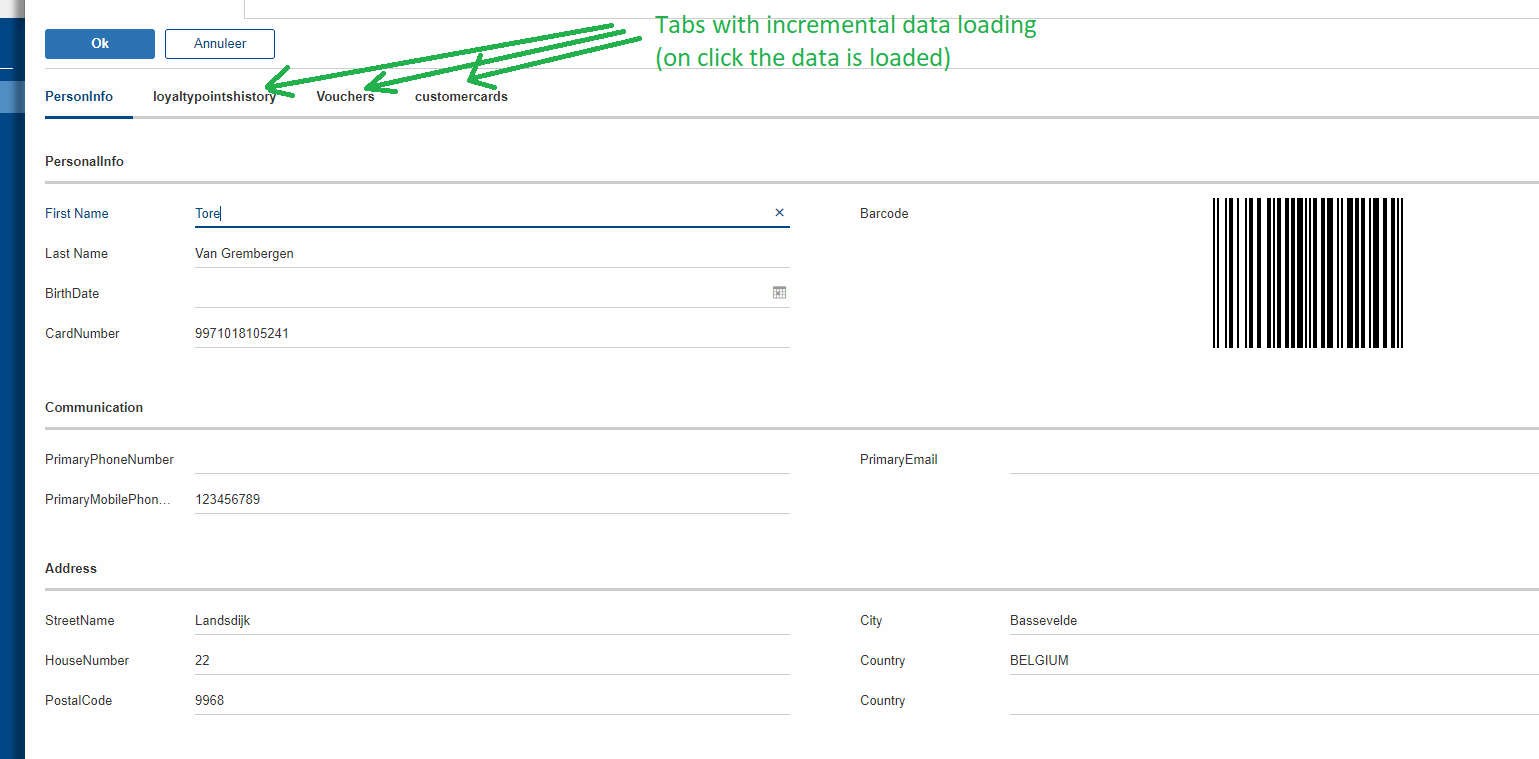

I have created a tabbed page setup via a TabBox with different groupboxes.
index.php/fa/36029/0/
		@Order(1000)
		public class PersonDetailBox extends AbstractTabBox {
			@Order(1000)
			public class PersonInfoBox extends AbstractGroupBox {
				protected String getConfiguredLabel() {
					return TEXTS.get("PersonInfo");
Most tabs contain tablefields

The idea is to have the dataof the tablefield loaded of the different groupboxes via the "on click" of the tab to simulate incremental page loading.

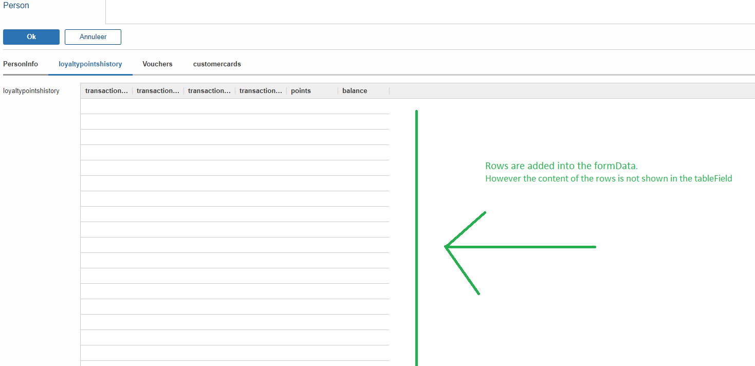

The different rows are retrieved, but the data is not show.
(see screenshot, rows are added to the tablefield, but the content is not shown.)

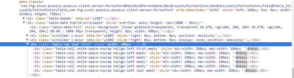

I checked the HTML and the rows are in the HTML, but data is empty

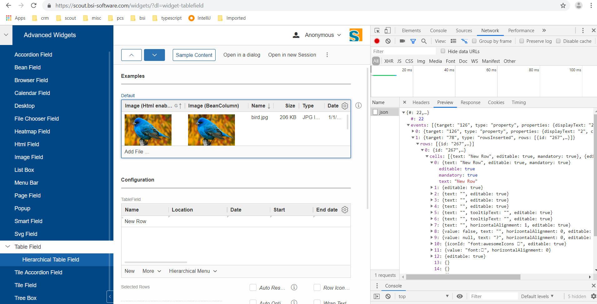

it looks like the table cell values are missing indeed, as you already have noticed. You can verify that it is not a UI (=JavaScript) issue by checking what is sent to the browser. If the json does not contain the cell texts it is likely an issue in the Java layer and the UI works correctly.
index.php/fa/36030/0/

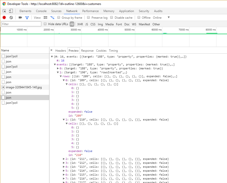

Re: Tablefield - Tablefield data not shown on a tab in a groupbox [message #1810072 is a reply to message #1810069] Tue, 30 July 2019 05:43 Go to previous messageGo to next message
As far as I can see, the json file is showing the rows, but the rows look empty.
index.php/fa/36031/0/.

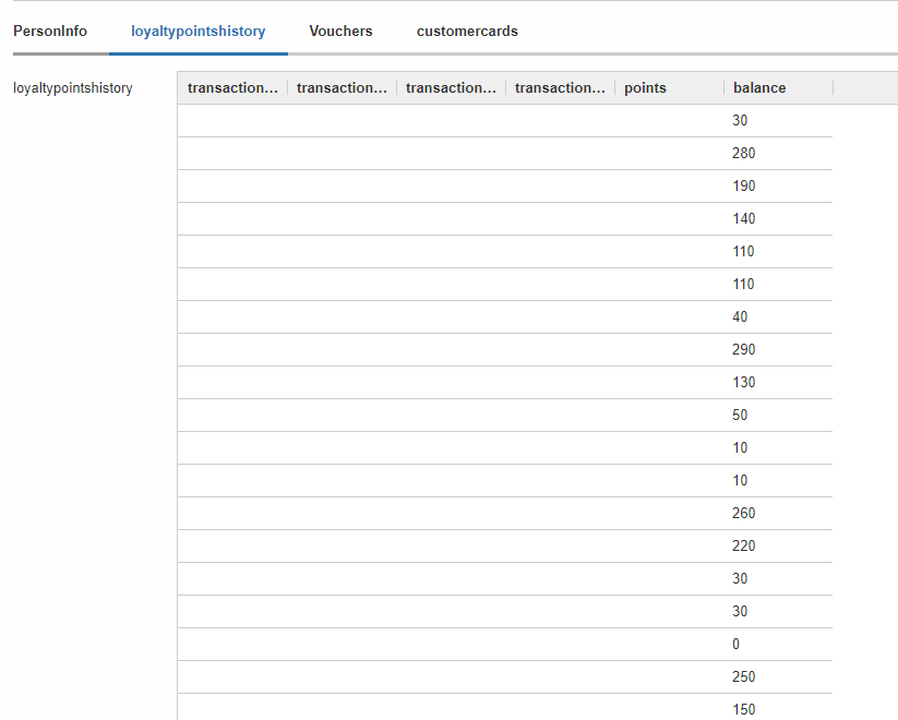

Is it possible that the issue is related to this part of code in TableRowDataMapper ?
  protected IColumn findColumn(ColumnSet columnset, FastPropertyDescriptor rowDataPropertyDesc) {
    String columnId = capitalize(rowDataPropertyDesc.getName());
    return columnset.getColumnById(columnId);
the field balance is e.g. translated Balance.
  @SuppressWarnings("unchecked")
  public <T extends IColumn> T getColumnById(String id) {
    return (T) m_idIndexes.get(id);
When looking up balance with Balance, the above code returns null.
I changed the field from balanceColumn to BalanceColumn and the data showed up.
index.php/fa/36043/0/
I don't know if this is by design or a bug ?
