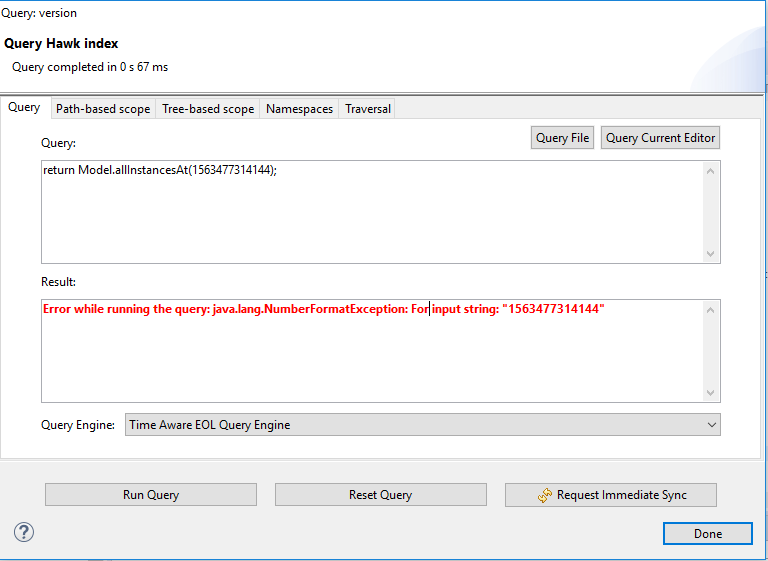

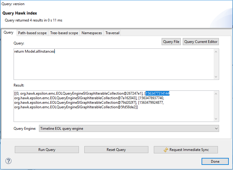

The Model.allInstancesAt() returns a numberFormat exception which is likely because the parameter is parsed as a string instead on number. I have attached a screenshot of a working timeline query and the time-aware query that throws the exception

Hi Saheed,
Thank you for reporting this. I have tweaked some of the unit tests, and they showed that "Model.allInstancesAt(0)" failed because EOL was not promoting the Integer 0 into a Long 0. I have added a work around that should fix that.
On the other hand, your issue is a bit different. You are entering a numerical value which is above the valid range of an integer value, which explains why Epsilon (not Hawk) is complaining about that large number. You should add an "L" suffix to your number so it is correctly parsed as a Long value:
return Model.allInstancesAt(1563477314144L);
Hope it helps,
Antonio
