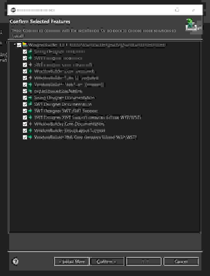

Gentlemen,
I'm a long time user of WB, since it was paid. (US$ 150 per year, I guess).
My current install WB just stop working and gives me error like below:
An error occurred during the org.eclipse.equinox.internal.p2.engine.phases.CheckTrust phase.
session context was:(profile=S__Eclipse2019_eclipse, phase=org.eclipse.equinox.internal.p2.engine.phases.CheckTrust, operand=, action=).
Error reading signed content.
Exception in opening zip file: C:\Users\aless\.p2\pool\plugins\org.eclipse.wb.core_1.10.0.201812270937.jar
I've already tried the following:
* Fresh Eclipse install (4,11)
* fresh workspace
* -clean boot
* WB 1.9.1, "latest", 1.9.2
All of then failed.
Attached goes WB install request.
  • Attachment: WB_001.jpg
    (Size: 9.14KB, Downloaded 163 times)
Re: WB install error [message #1821932 is a reply to message #1809992] Sun, 23 February 2020 09:02 Go to previous message
Do not install XWT support (it requires WTP)
