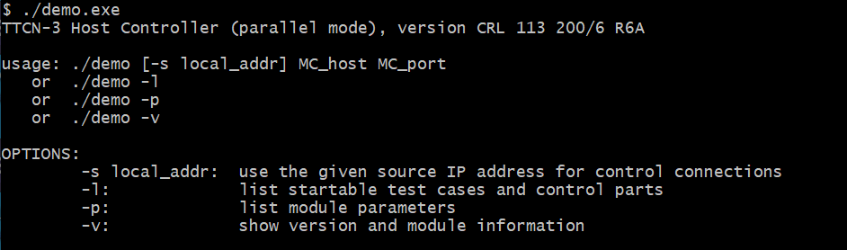

I am having a strange issue that I cant seem to solve. I am compiling a test suite for TTCN3 and after compiling all the executable does is print out "test start". I have tried compiling the demo example and it correctly prints out "TTCN-3 Host Controller (parallel mode), version CRL 113 200/6 R6A" when run. I am also able to run the test cases on the eclipse plugin.

Your demo.exe was compiled in parallel mode. It can be run this way (see UserGuide.pdf/Chapter 4.4):
ttcn3_start demo your.cfg
(If you had installed "expect")
If you don't have expect, the more complicated method should be folllowed according to 4.4

Also I'm not actually having any trouble running the demo.exe I was using it as an example of a what I thought I should expect. The issue is that for some reason my test.exe does not contain any test cases or control parts or anything. All it does is print out "test start". I tried running my colleagues compiled test.exe and that actually outputs what I would expect and it also contains the test cases and control parts. I am pretty sure we are compiling them in the same way.
