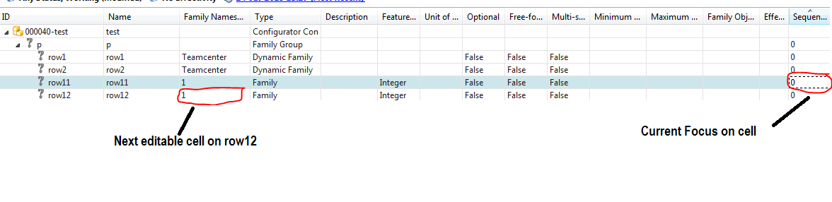

Switch focus from one tree cell to another tree cell and when the target focus is on the next line/row of tree table, this issue occurs.
Usecase:
Consider I have a tree table with 2 rows/entries i.e. row1 and row2
The current focus is on the last editable cell of a row1.
Press TAB key, the focus should shift to next row's first editable cell i.e. row2's first editable cell.
But NPE is observed
