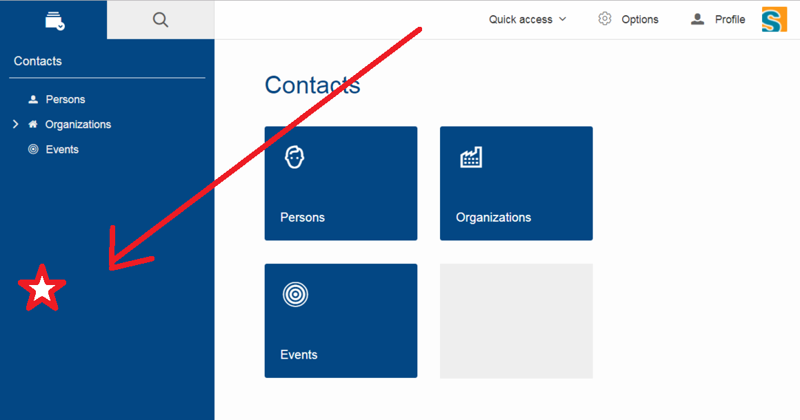

i may have a strange question. Maybe i tried it at the wrong points, but i just cant find a working way.
The basic need why i want(need) to do it is, we have a custom DenseMode Setting in which the menu in the upper right corner will disappear and the user wont be able to logout if he doesnt exit DenseMode before.
So what i want to achieve is to put the UserMenu from the place it is to the outlilne itself. There it may be shown as an icon or text (link?) that doesnt matter at all.
Is there any chance to achieve this?
Excuse my poor drawing, i hope you still get what i want to do.
Thx in advance for your ideas.

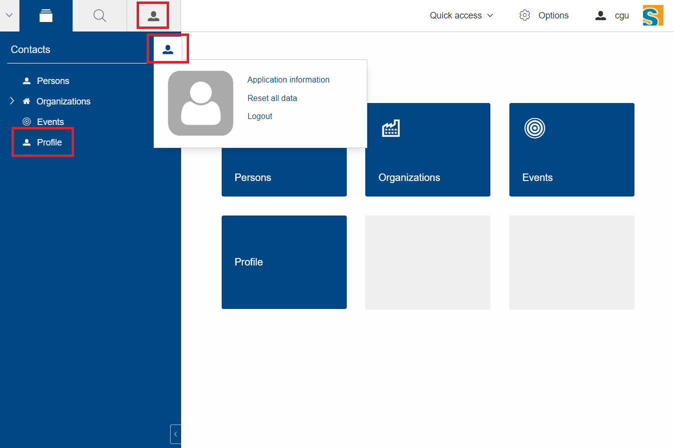

you have several options:
index.php/fa/36006/0/
The simplest one would be to use a header menu. Just put this in your outline:
  @Order(2000)
  public class ProfileHeaderMenu extends AbstractFormMenu {
    protected String getConfiguredIconId() {
      return Icons.PersonSolid;
    protected Set<? extends IMenuType> getConfiguredMenuTypes() {
      return CollectionUtility.hashSet(TreeMenuType.Header);
    protected Class getConfiguredForm() {
      return UserForm.class;
You could also create a view button. But unfortunately the view button will change its background-color as soon as it is clicked even though it is not explicitly marked as toggle button. This is probably not what you want. To circumvent it you could override the rule using CSS.
ViewButton in Desktop.java:
  @Order(3)
  public class ProfileViewButton extends AbstractViewButton {
    protected DisplayStyle getConfiguredDisplayStyle() {
      return DisplayStyle.TAB;
    protected void execAction() {
      new UserForm().start();
Another option would be a regular tree node / page. Either open your user form as dialog or use a detail form to embed it.
TreeNode in Outline.java:
    pageList.add(new AbstractPageWithNodes() {
      protected String getConfiguredTitle() {
        return "Profile";
      protected boolean getConfiguredLeaf() {
        return true;
      protected void execPageActivated() {
If you wanted to place it on the bottom left corner, then you would need to write some JS code (basically extend DesktopNavigation.js or Outline.js and put the widget there).
Cheers
Claudio
