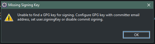

index.php/fa/35976/0/index.php/fa/35976/0/Hey,
I noticed that EGit now is capable of signing commits with GPG keys. Eventhough this works when just using the Git commandline, EGit sadly fails at finding a proper key as it seems (screenshot attached).
Any idea what might go wrong when I try signing commits? Also I didn't find any log files, maybe you know where these could be located.
Thanks in advance

Re: Latest EGit fails to sign commits with GPG [Windows] [message #1810096 is a reply to message #1809703] Tue, 30 July 2019 17:07 Go to previous messageGo to next message
Are there any errors logged? The log file would be in your Eclipse workspace, under directory .metadata.
EGit is looking for your keys in %APPDATA%\gnupg\, files pubring.kbx or secring.gpg. Do you have these files?
See also bug 549439 .

Call it with arguments C:\Users\Besitzer\.gnupg\private-keys-v1.d\FA78FB5C8C6B1B0D4CC992B62BE89C8D07DF94C8.key <your passphrase>. (Passphrase quoted if it contains blanks.)
If it fails, it'll print a stack trace. If it can read the key file, it'll print the public key's fingerprint (which I would expect to be 306ed1c8e21cdd2b).
If that fails, we know the problem is inside Bouncy Castle.
If it works, there's two possibilities:
  1. It prints a fingerprint starting with "306ed1c8e21cdd2b": there must be something wrong elsewhere; we need to keep digging through the JGit implementation.
  2. It prints a different fingerprint: the public key found in the pubring.kbx file is not the correct one. Your GPG setup is strange.

So Bouncy Castle cannot read this key. Jgit currently uses BC 1.61. Either this is not the way one reads these files (i.e., the code in LoadKey is incorrect), or there's a bug in Bouncy Castle, or the format of these *.key files changed between GPG versions, and yours is a format that Bouncy Castle cannot handle.
What GPG version are you using?
I don't have a clear idea how to go further from here...

For me it's btw no Windows issue. I tried it with a native Debian 9 installation and Eclipse, same issue.
As we see that this seems to be a problem of the BouncyCastle Lib I might also ask them about it - in case you don't see a problem with my GPG version.

Once this is done, I change my global git config to the email of that key and checked the java program you sent. Success. BUT here's the catch:
$ ./org.eclipse.jgit.pgm-5.4.0.201906121030-r.sh commit -m weird
fatal: Unable to find a public-key with key or user id: checkGPG@gpg.info
As it seems now JGit doesn't even find the key I freshly generated.
I'll send you the private key via E-Mail.
Re: Latest EGit fails to sign commits with GPG [Windows] [message #1810658 is a reply to message #1810645] Thu, 15 August 2019 06:57 Go to previous messageGo to next message
Does the key you sent make LoadKey throw an exception? I can load that key fine with the little LoadKeys program on my Mac.
After fixing the key lookup in JGit (see https://git.eclipse.org/r/#/c/147766/ ) I also can use this key to sign commits successfully in EGit.
Key lookup is one thing, but there's still the problem with that key that fails to load altogether. You wrote above that was effectively also a throw-away key. Maybe you could send me that one? I hope that one doesn't load for me, too.
Otherwise... what Java version are you using?

Re: Latest EGit fails to sign commits with GPG [Windows] [message #1810721 is a reply to message #1810659] Sat, 17 August 2019 13:40 Go to previous messageGo to next message
EGit nightly now should include the improved key lookup.
Re: Latest EGit fails to sign commits with GPG [Windows] [message #1811030 is a reply to message #1810721] Sat, 24 August 2019 06:22 Go to previous message
Yesterday I updated Git Bash to the latest version, also updated the EGit plugin and eventually it seems to work just fine.
Thank you so much for your help, I learned a lot by this - sadly it was probably just a bug with the GPG which Git Bash ships.
